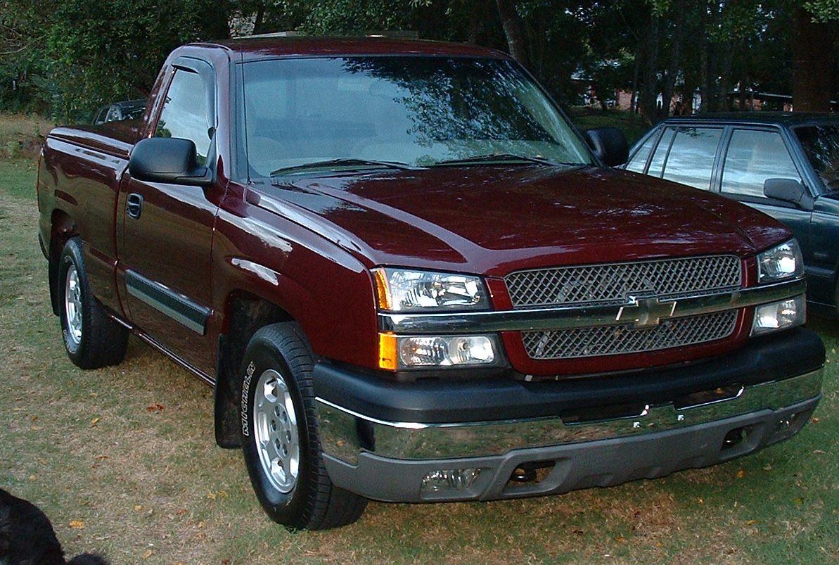

OK......I've got an '03 Silverado, reg. cab and bed, 5.3L V-8. Nothing really special, although it did take a minute to find it back in '13 when I bought it. This is her:
