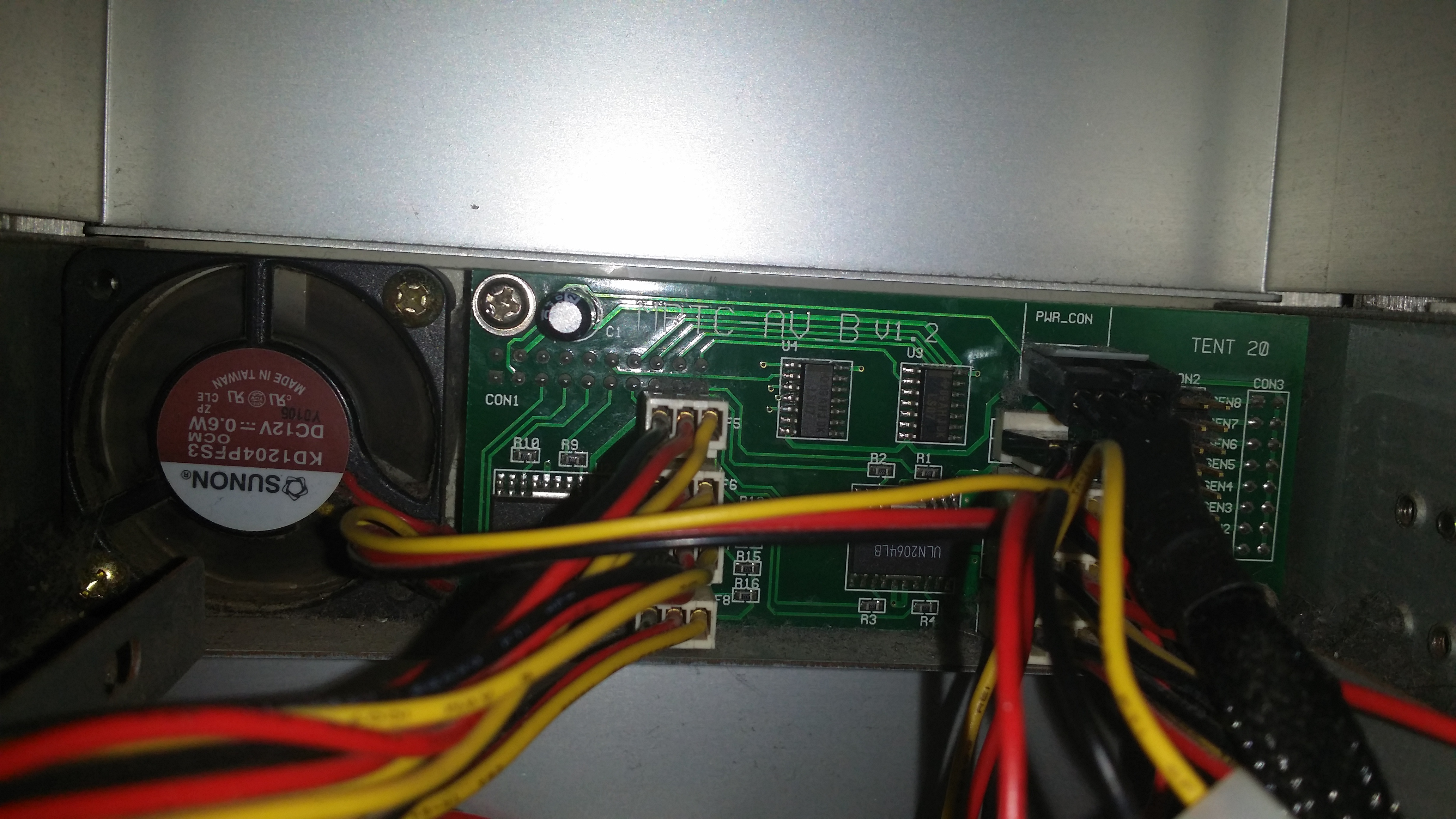

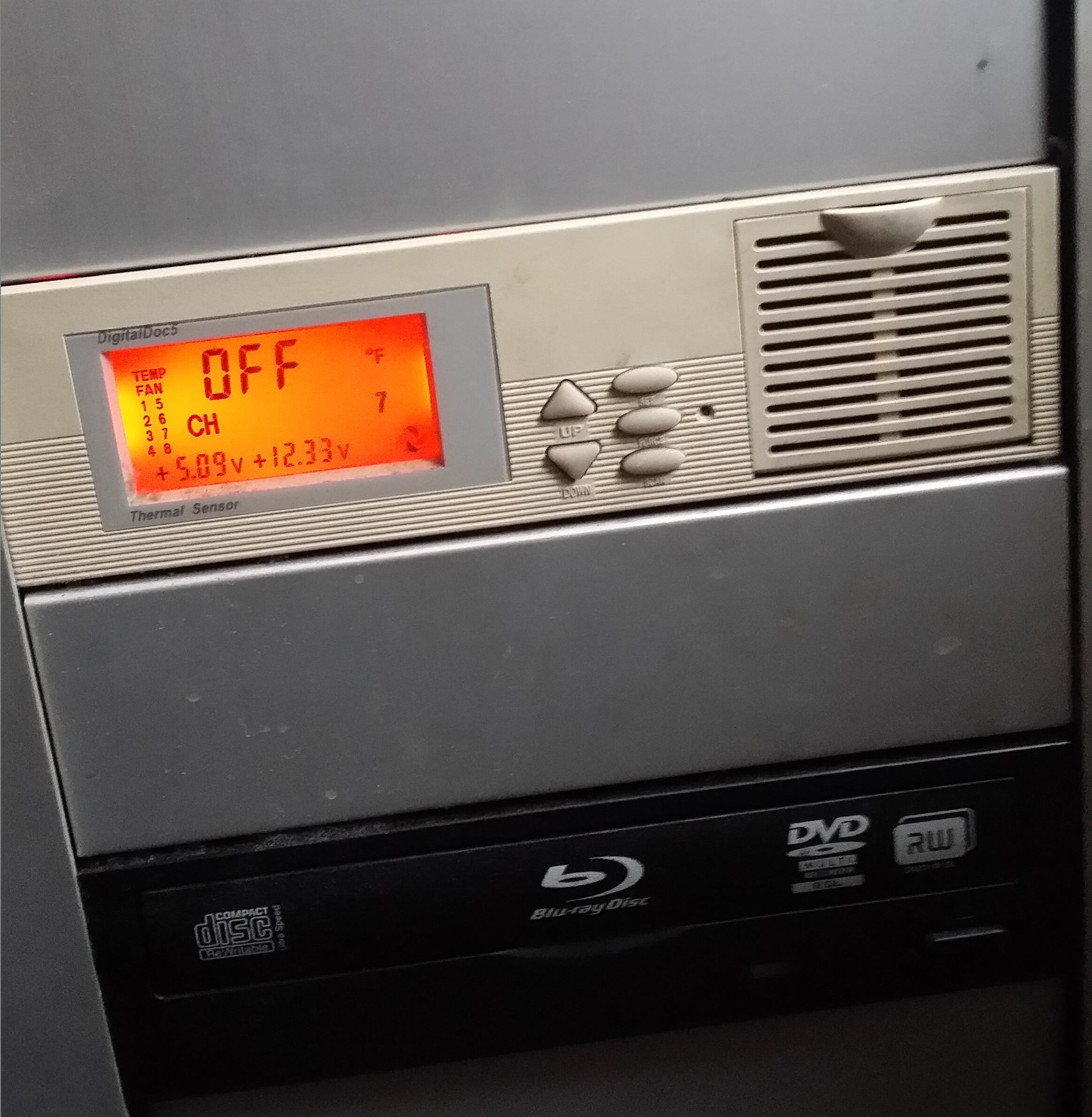

So I have had this case / DigiDoc V since 2001. I turned on my case today and the unit(powers my 10 case fans) started beeping and the fans powered on then off.
So far I am trying to figure out whats wrong? Anyone who can give some advice as to the proper steps? I am not sure if it hit the fan since when disconnect then reconnect the power cable, the fans all turn on for 2 seconds; then stop.
Would love some help. If the unit did hit the bed, whats the best way or more modern method to connect all of my case fans?
Thanks,
EDIT: Ironically after unplugging the power cable and plugging it back in after 8 hours the controller works again. Any ideas why this happened? Also, is there a better way to set this up? I do not know how to make the most out of this unit with the Voltage settings. I just have them as "Force on"
EDIT 2: Turned computer back on and failure, the unit is beeping again and starting then shutting off.

Ironically I turned on the case again today and guess what. Unit is not working. At this point I am going to buy a new one. I think I am going to go more high end. THe only main issue is that I do not want to put any of the thermal connectors in. So what I need is as you said,
A way to make a curve so that when they temp goes up the fans speed up ( a la games)

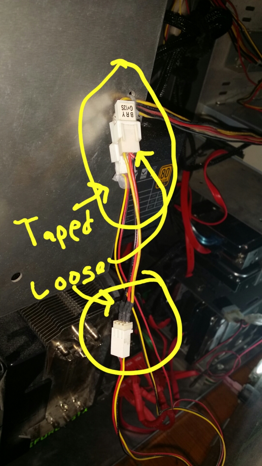

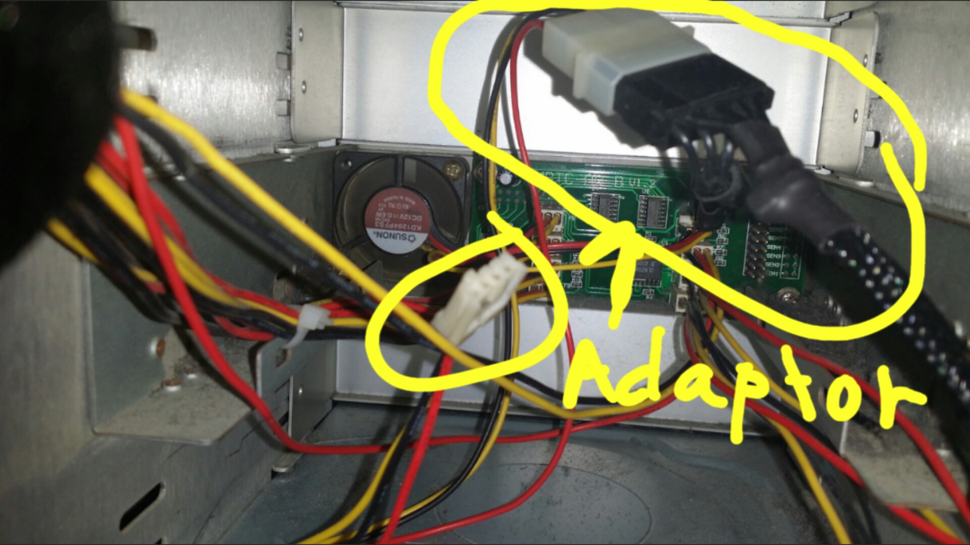

ok so I was away on and just got back.
Here are my latest troubleshooting.
The computer will not turn on when the short pin connector from my PSU (peripheral port with the large 4 pin power connectors and the small 4 pin conectors) are connected to the Digidoc. When I take out the cord it starts no problem.
I then used the cable I had used previously which is an adaptor cord to extend to more PSU connectors, The computer would boot, however the Digidoc would still only light up for 2 seconds then it would start beeping.
I then started the computer and after 10 minutes for some reason if I connect the power cable it works. Why wont it work on boot up? Also, it does not seem to matter if I have less fans connected or not.
The reason I like this unit is that it powers 9 fans. I never monitored the heat temps, I just kept the fans on at all times. Do you have any recommendations??
Thanks.
@bonzaiduck I dont really care about things looking good I just want the fans to stay on. I like the option of turning them off turning them on, however for me with my system overclocked the way it is I prefer to keep them on most of the time. What can I do to fix this?
Also, what unit would be the most simple and easy enough for me to use?

IN the photos above all the connectors in the fan have the 4 prong mini "floppy drive plugs"
I have 2 cpu fans on my heatsink and those are connected to the 2 CPU_FAN ports
I'm thinking that you're overloading a 12-V rail of your PSU. We need to sort this out, and then define a better strategy of fans and "control."
Also, without looking back through our thread posts, I assume that you have a fan connected to the CPU_FAN header?
Yeah, its possible that the 12 V is being overloaded, its just hard to believe since it has worked up until now. But it would make sense. For example I just rebooted the computer and the fans worked no problem. IT seems that the problem is intermittent. More often it seems to happen when the computer is shut down for a long period. Almost as if there is a short, or something is being tripped.

i am within 80% surity u burnt out that controller running 9 fans on it.
You dont run 9 fans on ANYTHING which doesnt have beefy mosfet sinks like a Sunbeam Rheobuss / Sunbeam Rheobuss Extreme, or has 9 fan ports so you can connect 1 Fan per channel.
http://www.jab-tech.com/fan-speed-control/sunbeam-5-1/4-rheobus-kit-black/
or is a 100% digital mosfet like a lamptron FC5 which costs 3-5x the sunbeam's.
There is no way u can handle more then 1 fans per channel.
Im actually suprised it lasted you 5 yrs with 9 fans....
Those mosfets were not able to handle more then .25amps per channel... which i believe u either pushed at the very edge of its limits or over its limits at 2 fans per channel.
A lamptron / Sunbeam can handle 1.5amps (normal sunbeam) - 2.5amps (FC5 or Sunbeam Extreme)...
and look at the massive sinks the sunbeam has to make this claim vs your digidoc which i know is not a 100% digital mosfet.
100% digital mosfet controllers like the aquero, and lamptron start at 90 dollars.

Not sure you saw the photo... all 9 fans are connected to one port. They are not sharing or crossed to anything.
In other weird news, I was on the phone with EVGA and they said there is a recall on my PSU and potentially that the PSU could be to blame since the unit works with the adaptor cable but not with the stock cable. They are in the process of sending me a brand new 1300 watt PSU lets see if that works. It would be interesting if I could get a cord that connects to the PSU and just connect the fans directly to it without the unit.
Ho! The plot thickens! You may get through this without spending a dime!
I could imagine 9 Noctua fans connected to one port: the total amperage might be just over 1.00+A. Like I said -- I'd looked at the Digi-Doc briefly some years ago when it was still being sold, but remember little.
