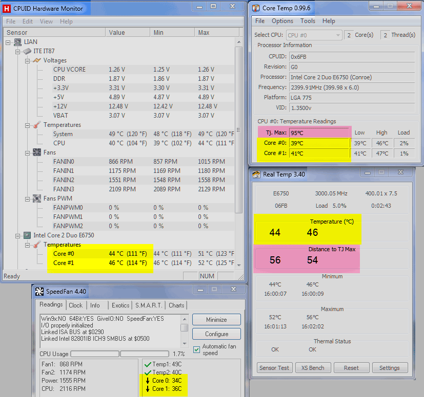

I'm curious why the core temps are reporting a 10° difference in CPUID Hardware Monitor vs SpeedFan.
The fans speeds report identically in both programs, as well as CPU temp. Just not the core temps. Any idea why, and more importantly, which one is more likely to be correct?

Thanks for the replies. I guess I'll go with the bottom line that software temp reports are basically unreliable, and just use them as a relative source of resource. i.e. I can tell if an OC has raised the temp, just not by exactly how much nor what the resultant actual temps are.
Masochist that I am, I also ran CoreTemp this morning and got a *third* set of temps:

My money is riding on CPUID HW & RealTemp, and they both report 44° and 46°.
CoreTemp uses TJ Max of 95° whereas RealTemp uses 100°.
Then I googled and found specs (at http://www.tomshardware.co.uk/intel-dts-specs,news-29460.html) which show the TJ Max for my e6750 chip is 80°:
Following that, I found a fascinating thread here on anadtech.com: http://forums.anandtech.com/showthread.php?t=218917 which, although sometimes way above my head, included some things like:

(PS: The reason my temps are higher than in previous posts is that I'm not using the air conditioning today. I live in Thailand, and today is less humid and cooler: only 30.5° in my room today. Previous posts using air con, room temp was about 24°.)
