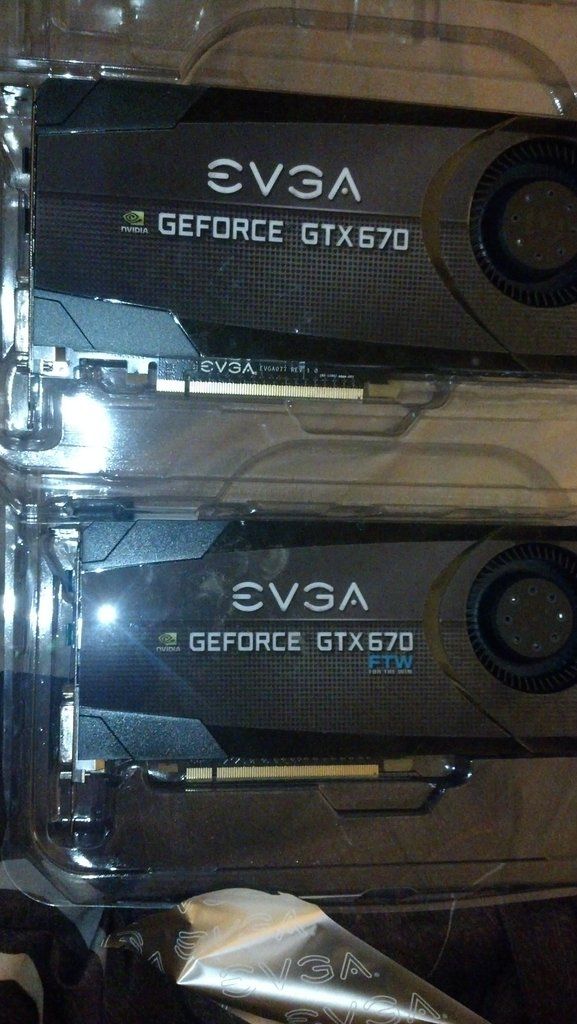

So I ordered 2 670 FTWs and I notice that the sticker on top of them are different one says FTW with FOR THE WIN under it and one does not. They are both 680 PCB and the SN is about 2000 apart. The one that says FTW actually turns out to be bad. Artificating (single card) in 3dmark11 after a few minutes even though the temperatures I read are okay. Also random driver kernel crashes when I added it in SLI to the other.
It ran fine for a day or so before deciding to crap out although I did notice that it did not boost at all. My first card hits 1280 no problem and the defective card just sat at 1050.
Curious if they changed something besides the top sticker that might be causing the newer FTWs problems.

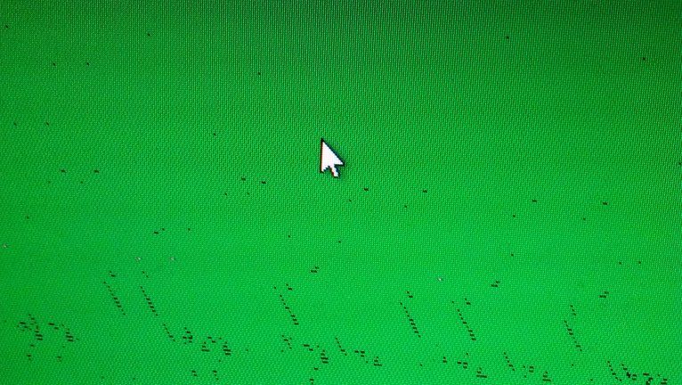

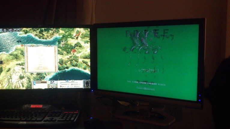

So card 1 passes furmark for 30 min and runs 3dmark11 fine. But when playing King Arthur the monitor attatched to the DVI-D port artifacts. I have not noticed it during another game, but I have only had the card for a very short time too.
The weirdest part is that if I drag a window to the artifacted monitor it will also artifact but if I put my mouse there it displays perfectly.

Issues with two cards makes me question EVGA QA I know they had issues with the SC cards already... could this be the reason they no longer offer a lifetime warranty? I had zero issues with my 570s in this same rig for 18 months.
So the question quickly becomes do I send BOTH cards back!? Seems crazy but I had zero issues prior to these cards and both cards have different issues (maybe newest issue is driver related?)

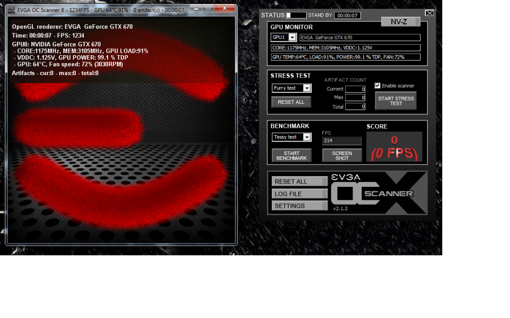

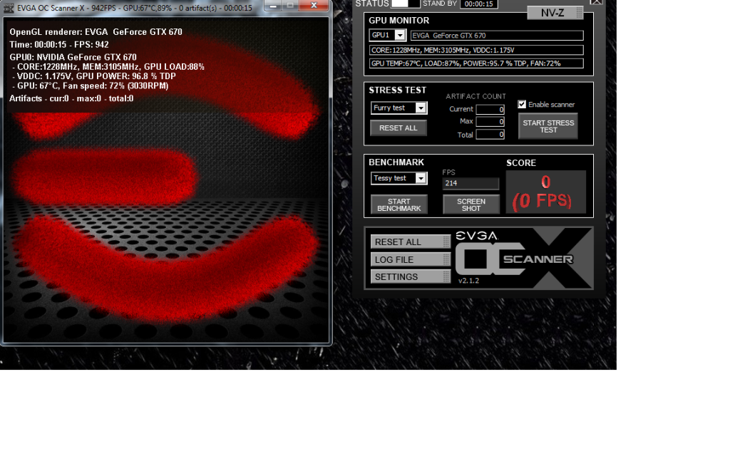

Okay so downloaded EVGA OC Scanner X at EVGA's request and with card 2 my system would just freeze before I could even start it.
I am running it with card 2 and I noticed a strange quirk that I am having difficulty figuring out. The only thing I do know is it is not boost related.
As a matter of fact the card seems to have a greater FPS sometimes with less core clock. I have taken a screenshot of what I am talking about.
Basically, sometimes I am getting 1250 fps running Furry test and sometimes 960. GPU Load for both is around 90 percent and power is between 1.100 and 1.175 (settings are stock).
If I put the voltage up even to 105% I get artifacts.
Can someone else with a 670 gtx run the OC Scanner a few dozen times and see if they randomly get an extra 300 fps on some occassions? It seems like an issue to me.
http://i1042.photobucket.com/albums/b428/digitaldurandal/960fps.png
http://i1042.photobucket.com/albums/b428/digitaldurandal/1250fps.png

If I set the Power Limit to 97% I consistently get 1250+ fps. If I set it to 102 I consistently get 960. I think there is something going on with the voltage tolerance of my card for sure. I guess I am RMAing both.
