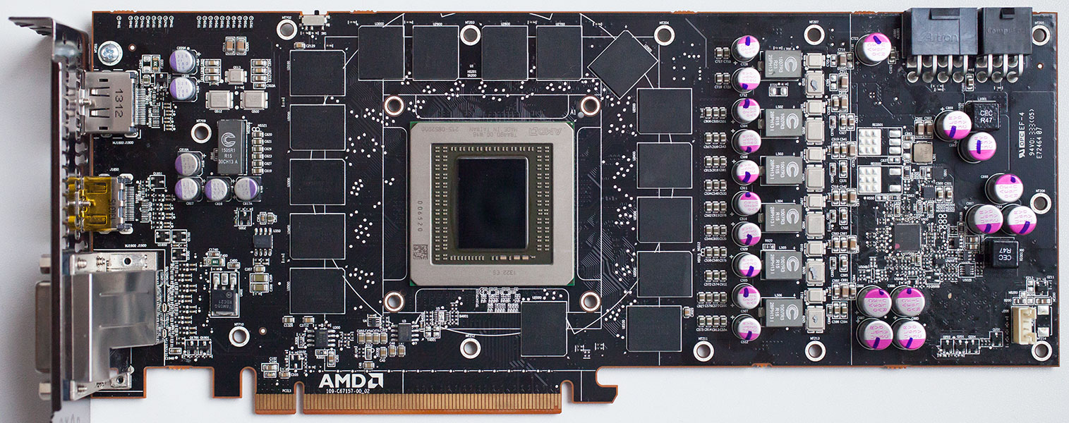

I have an Msi gaming heat sink for the card if you want something for cheap. I think you have to drill out a very small section on the back plate cause it was for a 290 and those don't have one capacitor that the X has. Seriously a 2 minute operation will make the cooler 100% operational for your card and miles better than the oem unit. Pm me if interested
The front looks identical.
R9 290 reference PCB
R9 290X reference PCB
I cannot find the difference on the back. Maybe you know where to look for.
R9 290 reference PCB (back)
R9 290X reference PCB (back)
I'd take lava's offer though if the noise bothers you a lot on the reference 290X.
All you need is setup Afterburner, down-volt by 50mV and it'll run much quieter.
That's it. No stupid noisy reference blower.
GCN responds very well with undervolt.
Russian, I actually think the difference is between the amd reference board and the Msi gaming pcb. After refreshing my memory it's the cluster of 4 caps in an L shape near the display outputs. The Msi revised board doesn't have those caps but everything else is the same. I'd post a picture but I'm on my iPhone and can't figure out how to get out of he new mobile interface.
