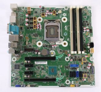

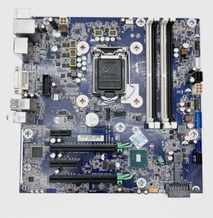

Heck if you're going to transplant into ATX chassis, there may be better options. For the Z240, you'll need an ATX 24-pin to 6+6 pin adapter cable. I would go either with COMeap or Moddiy brand adapter cables, latest cable revision supporting Z240 TWR and SFF. These companies were the earliest to market this solution for adapting an ATX PSU to the proprietary HP motherboard connectors.
Also you might consider the SFF variant not the tower. 1) SFF units tend to be cheaper 2) the motherboard for the SFF is nearly identical in features and supported processors (they share the same BIOS), but IMO has a better layout for the SATA connectors. The tower board has them all over the place, while the SFF board are neat in a row. Plus the tower board has that protruding connector on the side for optional PCI slot expansion board. See:
TOWER
SFF
In2Photos
Mar 21, 2007
2,623
2,793
TOWER
SFF
Thanks, that's some good info. Looking through eBAY it doesn't look like the SFF version is much cheaper, but it does provide some more options. Seems like most of them have less RAM and very few have a GPU so I'd need to find one with at least a 7700 for decent transcoding if what I read is correct.
