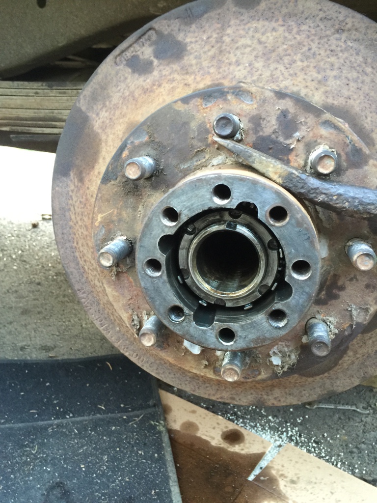

Thanks for the input guys! God damn the driver side rear drum was completely seized. The caliper Pistons were completely maxed out and not returning ended up getting new pads and calipers and now I got that seized drum 90% of the way off I'm pretty sure the parking brake is stuck on and the pads are somewhat fused to the drum. it's being a goddam beotch ran out of daylight must continue tomorrow. I added dot 3 from a can that's from the 80's. No problems so far haha
3/4 ton 8 lug 79's drums are the one drum that I only did once in automotive school. So it took me a minute to remember that u had to take the bearings out haha
