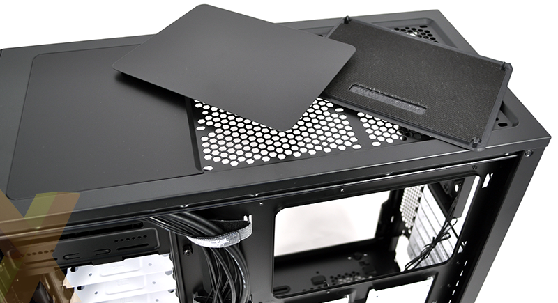

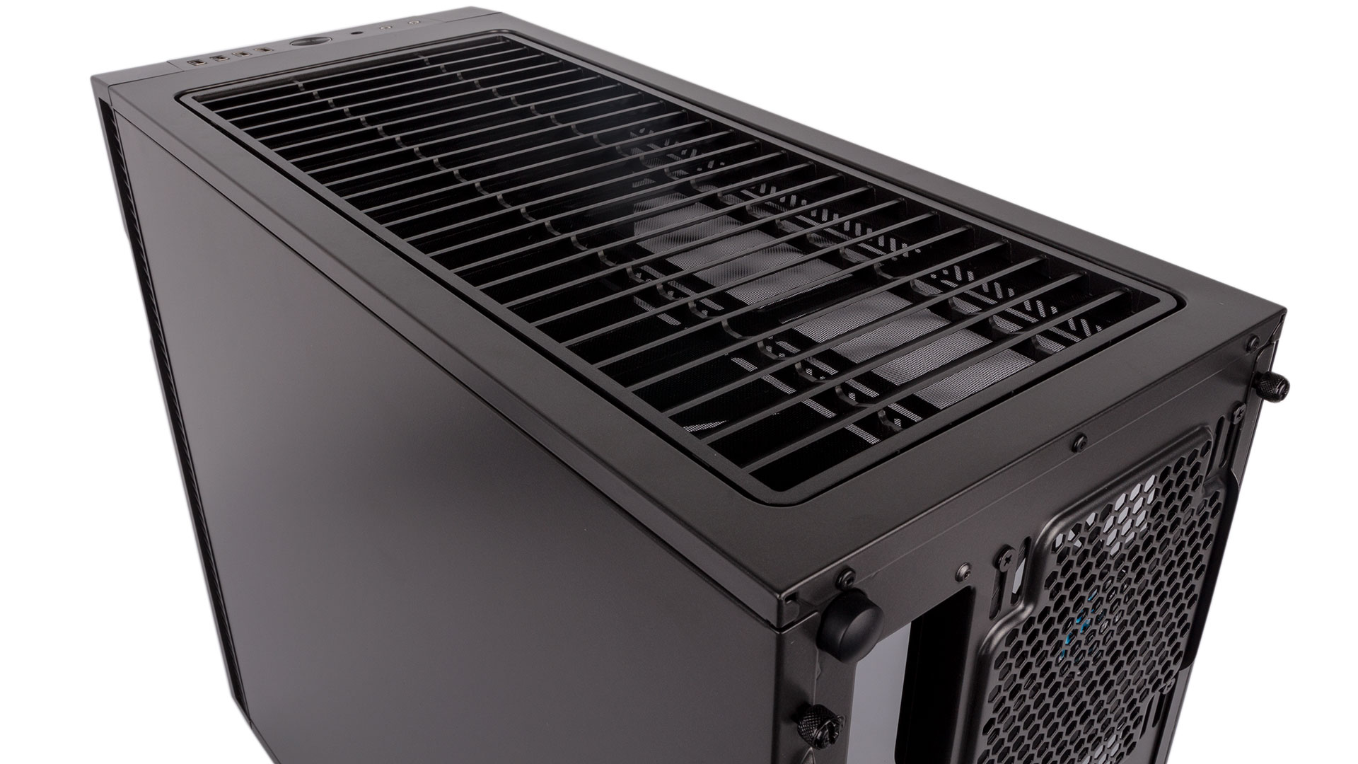

The one thing that I hate the route Fractal Design has gone with after they released the R5 is the top panel options. With the R5, you had the "Moduvents" and could open up individual openings for a fan. I found that only opening the very back one (along with adding a fan up there) offered the perfect balance of performance vs. quietness.
Beginning with the R6, they took away the individual vents, and if you want any fans / radiator up there, you have to open up the entire top, which allows a lot of noise to be heard. Until they offer something again other than opening the entire top, I personally wouldn't go with any more of their cases. I own two of the R5 cases, and they are still being used in both of my kid's computers.
I still have an R2 and I also have the "back" top vent open with a 140mm fan Well I think about 10 years ago when I made my first build in this case I probably overdid it with the fans but haven't changed the layout since.

While I also wouldn't call the R5 silent, it was quieter with only one of those top vents opened. My current case, the Be Quiet Dark Base 900 is much better in the noise department, as they have small slits on the top of the case where a top fan can push air out, while being pretty surrounded by sound-deadening material. It does knock down the airflow quite a bit by using that design, but enough gets pushed out at the top so as to not have collect up there.
