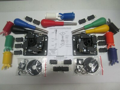

I have built joysticks from scratch before. Well I didn't build the housing cause I have no wood working skills, but other than that I have. It depends if you want US parts or Japanese parts. The standard Japanese parts are Sanwa and the buttons/joystick alone will run you probably close to $50 for one player. If you want to use US parts the standard brand is Happ which I think was renamed to IL or something like that. The buttons/joysticks are cheaper.
I replaced all the buttons in my KI2 cabinet and just searched email and this was the listing for it:
$44 for 2 joysticks and 14 buttons. And they were genuine Happ parts.
I'm not sure what you plan on doing about the housing for it. But that is going to cost you too. And then whatever PCB you decide to use, that will cost you as well. There are PCB's out there that are designed specifically for this stuff too. Back when I was doing it I used a Cthulu board but I think that was for PS3. There are probably PC ones too, like this one here:
Housing's can cost a lot too, but it just depends what you want to do.
Also here is an old thread I made about DIY joysticks. Most links are probably dead now though.
