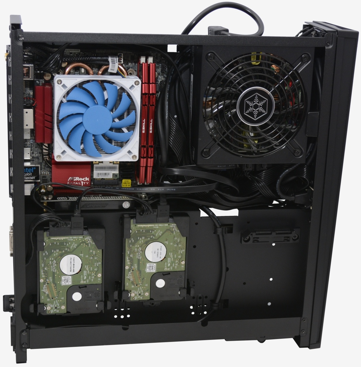

Some interesting points:
1. Despite the small desktop footprint it can accommodate up to a 13" video card. (If a short enough video card is installed, the surplus area can be used to mount either a 3.5" or 2.5" drive)

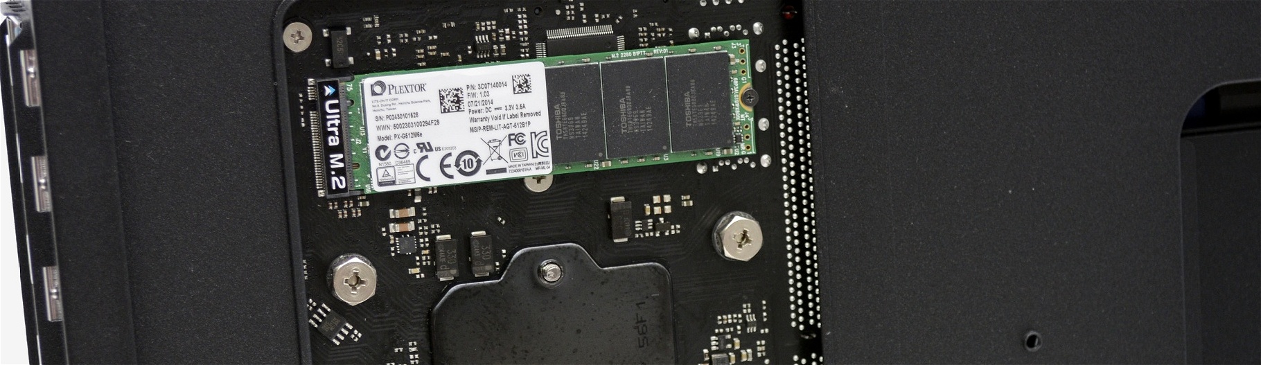

2. There is a cut-out on the back of the motherboard tray that allows access to the awkwardly placed M.2 SSD slot commonly found on the back of LGA 1151 Mini-ITX motherboards.
3. Despite the small volume of 12 liters every PC component is directly accessible without removing other components first (other than the side panels of the case itself).
4. A carrying handle is available for this case (and the internally identical ML08):
http://www.silverstonetek.com/product.php?pid=689&area=en
Some things to keep in mind:
1. CPU cooler maximum height is 58mm. (As a point of reference the new AMD FM2+ 95W Quiet cooler with the copper base is 58mm tall as is the blue fan Argon AR06 cooler shown below. However, notice how the vents make running the maximum size cooler feasible from a ventilation standpoint):
2. It uses SFX and SFX-L PSUs which are more expensive than ATX PSUs.

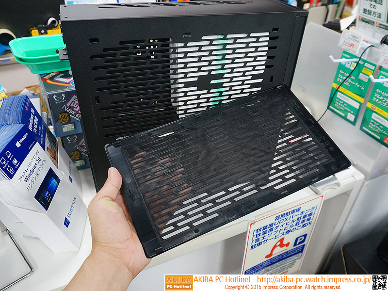

That is right, I didn't notice this Black version has dust filters (seen on page 3 of the manual below):
http://www.silverstonetek.com/downloads/Manual/case/Multi-RVZ02-Manual.pdf
What is the difference between the r02 and ml08b ? They look very similar.
Internally they are the same.
