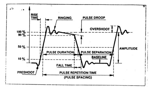

For example, see this image with some tech words that are very important to know when it comes to signal integrity.
Impedance mismatch would cause excessive ringing. And then a 0 or 1 may be seen on a glitch caused by ringing and not on the desired edge or moment in time.
Think subjects like DDR (Dual data rate), QDR(Quad data rate), timing, phase locked loop. Everything gets critical.
