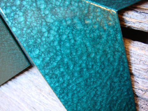

There are lots of options for finishing the cabinets, not sure if you have a plan for that. Probably the easiest thing is truck bedliner in a spray can - nice textured black paint that hides any defects. Rustoleum & Krylon also have a lot of cool spray paints, like hammered, camo, and stone, as well as the regular metallics and matte/glossy colors. I'm doing a 7.1 set for my brother right now with Rusoleum's Hammered Green on the faceplates, which looks pretty cool:
