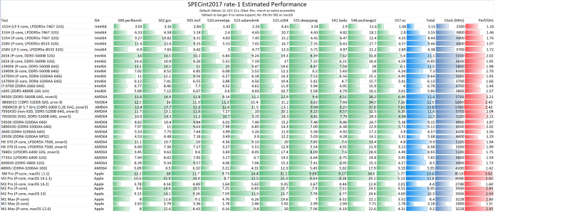

His results are little strange with the HX 370 too. The 5c cores are slightly slower per clock, not faster.
26,030
17,959
285K with proper memory would be a bit higher total..
I think Huang goes for JEDEC speeds to isolate the core performance except where the RAM is soldered so don't think he's gonna be doing 285K with DDR5-9600 anytime soon :(
His possible reasoning may be that the CPU's cache subsystem should shoulder the burden for keeping the cores fed, instead of overclocking RAM.

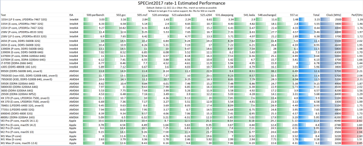

LPDDR is slower than non LP variants, even higher bandwidth LPDDR vs lower bandwidth DDR, close to 10%, for example 6900HS vs 7735U in laptops.
So something to keep in mind when comparing M3 variants vs x86 desktop counterparts.

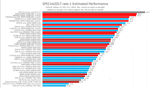

On another note, Skymont looking really good here.
"Per clock" results vary depending on the clock speeds at which they are obtained. "Iso clock" comparisons would paint another picture.

So then explain Oryon-L performing 20% lower. SpecInt isn't affected that badly by clock scaling.
