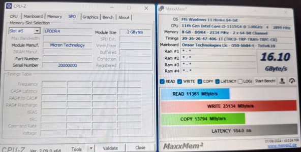

So I got this laptop for about $180 and I thought it was a real deal. Came with a stylus and the build quality was pretty good. But in experience, it feels like a darn netbook!
So I checked what was wrong with it and look at this:
Grandmas have faster reflexes than that latency!!!

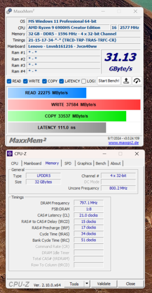

@Det0x , it seems LPDDR4 and probably LPDDR5 have serious issues where despite being CL20, the latency is almost 2.5 times as bad.
@adroc_thurston may be able to shed some light on the why and how.
Interestingly, slots 1 to 4 are empty. This was meant to be a 16GB laptop but it was cut down. So that might affect the bandwidth but don't think the latency will improve even with the full 16GB.
Can you replace the RAM? I wouldn't buy a laptop that wasn't easy to work on.
LPDDR4. So it's soldered.
I bought it more as a curiosity coz I had used an i3-1115G4 before but that one had fast DDR4 SODIMM, at least 2666 or more.
This one seems to be DDR4-2133 CL20 which shouldn't be this slow but adroc mentioned that LPDDR memories have very high latencies. He was right.
