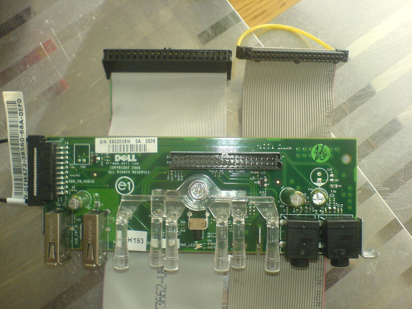

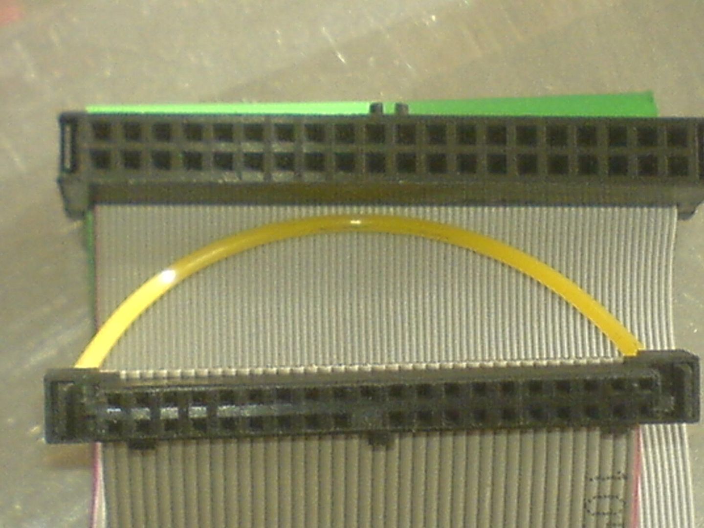

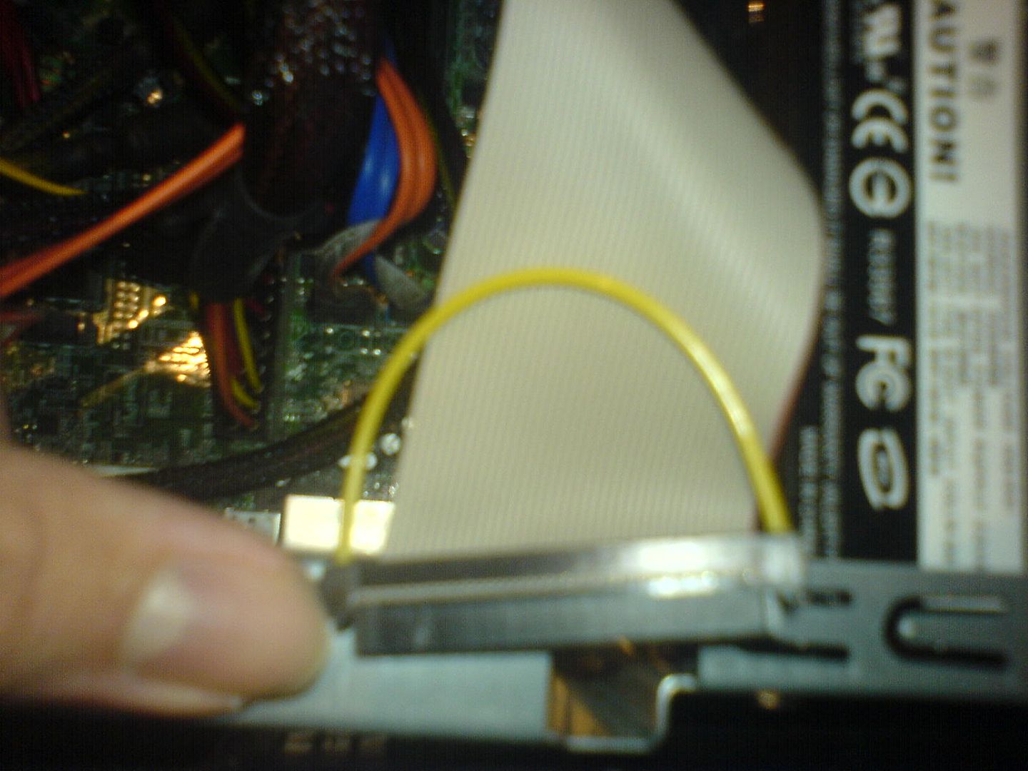

But I noticed that there where some small holes [damage] in the ide that goes from the mobo to the powerswitch/front usb's, jacks and lights.
Seeing that the pc is powering on in a strage way, it would make some sense that this may be the problem. But I can't see how this affects videe. Am i right or wrong? Where can i get another IDE, its not as wide as the ones on cd or floppy drives.
its 20x2 [40 in all ] with one missing in the centre but it's smaller than the normal IDE. Whats this called? Is this a dell specific thing? is the problem something else?

the front panel cable was run undeer the case and shorted out on the mobo, I advised that a new FP caable be procured before doing anything else. I advised that to test system without said cable and to manually jumpered the pins for the switch on the mobo to test the system out fully.

If the mobo is shorted, doesn't that mean it's damaged, and a new cable with this mobo will make no difference?
I have a new cable in the post for backup mobo.
I have no idea how to turn the pc on without the on button. If theres a fair chance of me damaging something I'd prefer to wait a couple of days for the new cable.

To turn on the PC without the on button connected, simply momentarily touch both the on button's header pins on the motherboard with something conductive, like a metal screwdriver blade.
I'm suspecting you may have incorrectly replugged some of the wires/cables after your cleaning.
PS - What you call an "ide" is normally called a "ribbon cable"; "ide" refers to integrated drive electronics, a type of hard drive interface, and to the cable it uses.
