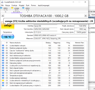

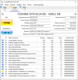

Could bad sectors on the TOSHIBA DT01ACA100 (1000.2 GB) drive have been caused by faulty power supplies, or are they more likely due to age and high total operating hours?

Your crystaldisk screenshots are in a foreign language so I didn't attempt to read them, but in general a bad PSU is more likely to cause file system corruption, loss of files rather than bad sectors, so I would suspect that the HDD is at end of life and should be replaced ASAP.
