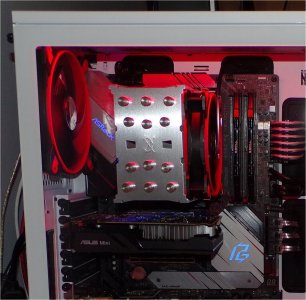

That looks nice, how does it behave with normal size DIMMS? I see a lot of these air coolers as big as a reviewers head, a long way from the ORB coolers from 25 years ago.
is it overkill?
It is large, but does not cover the DIMM slots at all. All 4 are completely open.
I like overkill when it comes to CPU coolers. I even put a stronger fan on mine, definitely not required, but I wanted it to match.
Reactions: VirtualLarry
Nice interior decorating! we're on the same page, per your inclinations. I'm waiting to see what cooling requirements Arrow Lake demands, before I also make a choice to buy an air-cooler. And the new processor is just one of my options at this point.
