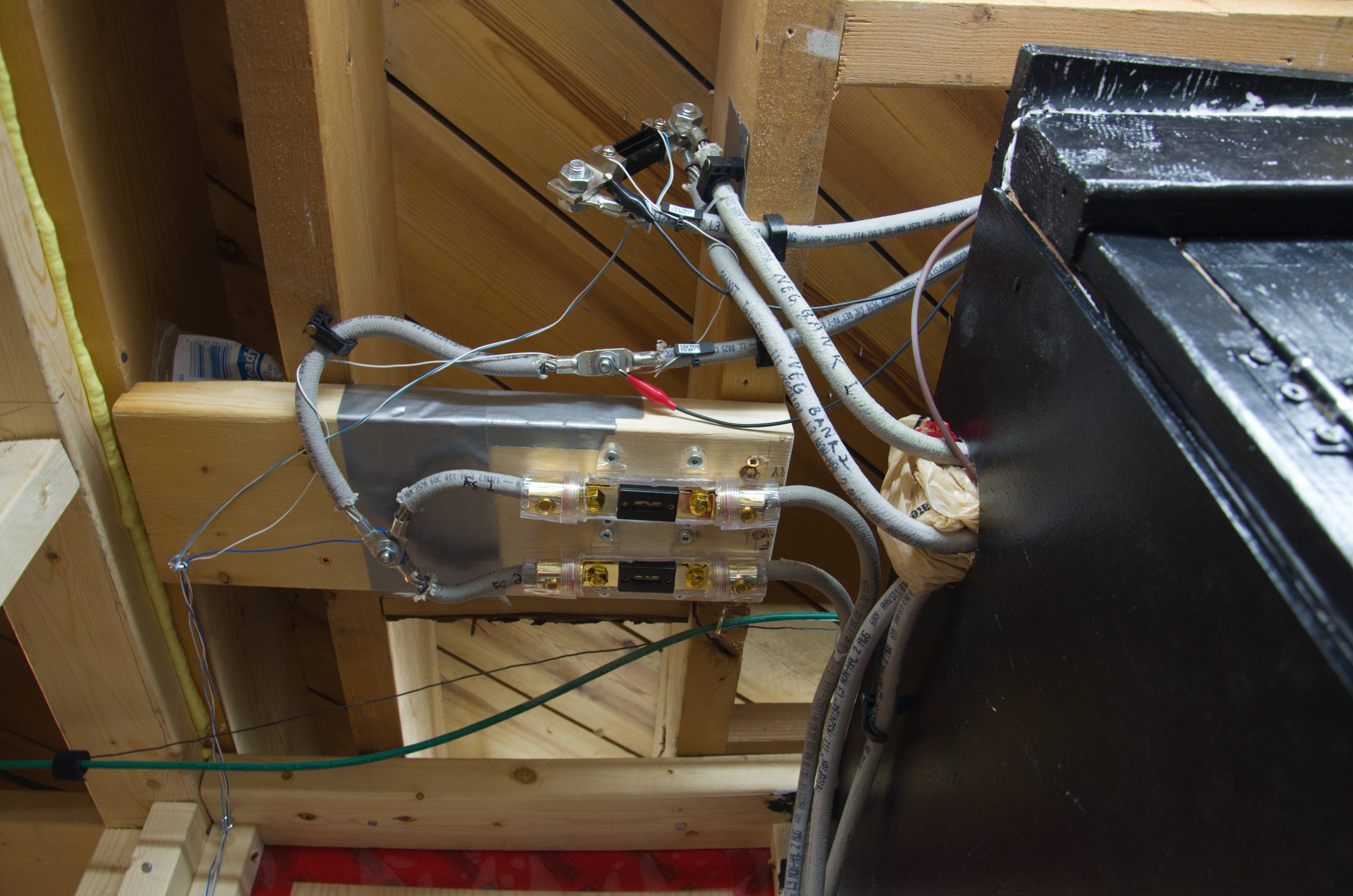

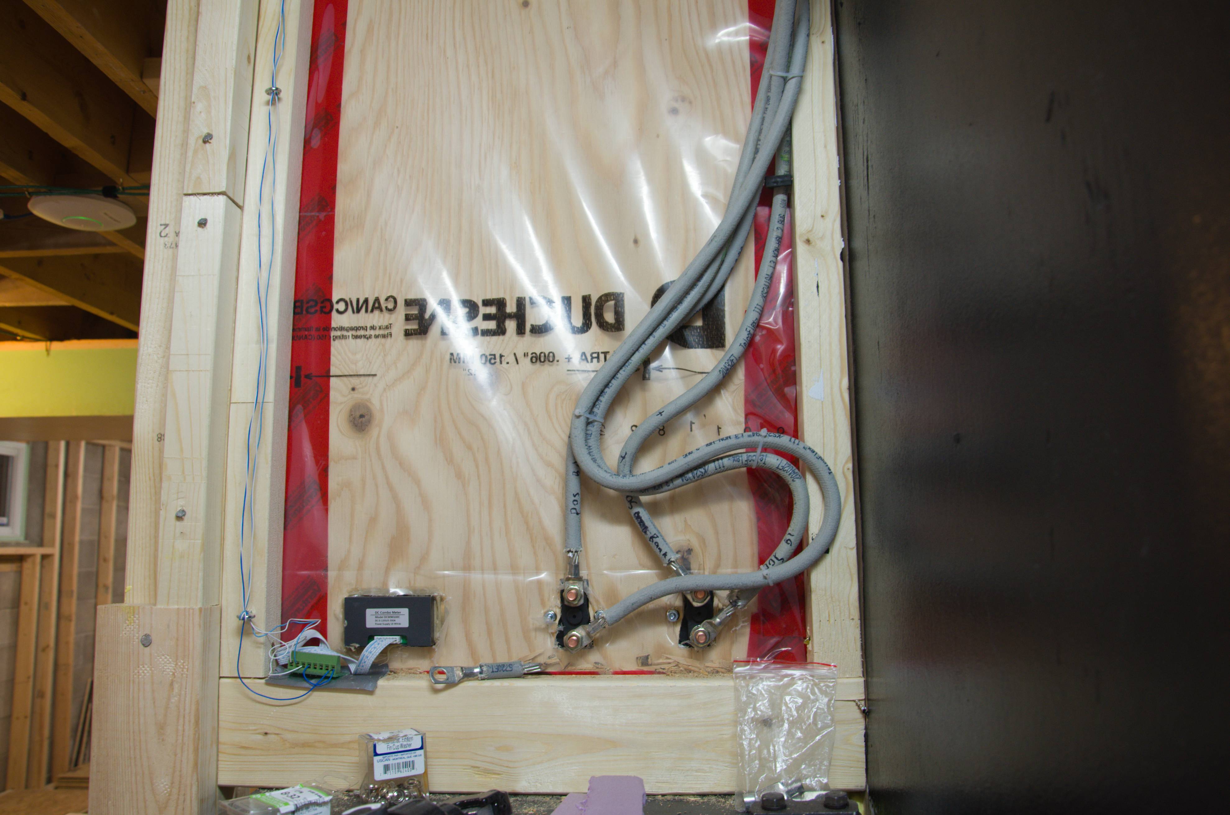

I ended up going with a Trippe Lite inverter-charger. It's essentially a UPS, but with connections to put your own batteries. It was cheaper than buying a used UPS on Ebay, due to the shipping cost of used UPSes. (some sellers were asking like $600-$800 for shipping alone).
So basically what I got is a battery bank split up in two for redundancy (two separate switches and two separate fuses so I can isolate them for maintenance) and then the main PDU is plugged into that UPS.
Older pics but this is basically the setup, it's just not fully complete in some of the pics:
The amp meter portion of that is useless - the numbers jump all over the place, measuring current off a shunt is a very tricky thing to do due to picking up noise after the very tiny voltage change is amplified to ADC levels. I need to revisit it at some point.
There's two batteries per shelf. idealy I'd like to put 4 per shelf but I would need to make some custom plastic trays so I can fit them all properly. Been toying with even moving the batteries to a separate room in a battery box that is vented as it's own system. Basically could get away with small ABS pipes and a small HRV unit to try to recapture the heat so they don't freeze. Right now my whole setup is just free air vented, but I do plan to enclose the walls eventually and make it an actual room.
The DC side is kind of ugly, I want to redo it one day. Been toying with going solar too, so I'll probably do all of this as a single project. Would be 48vdc dual conversion with solar added to the mix.
