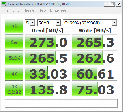

Haven't got alot to say about the Crucial as they are still trying to work through issues with firmware updates but there hasnt been much (if any) negative with respect to the OWC drive. I reviewed the OWC Extreme Pro RE and if I can't break it....well eheheheh.
But seriously if money is not an obstacle I might consider the RE as it has 28% over provisioning and is still pretty much the only drive that makes the claim of no performance degradation as the drive fills and with age...and tests haven't shown any reason not to believe their claim.
I got better readings out of the drive full than I did with just the OS and empty.
With respect to the OCZ, like the writer says above, when he avoids filling them... To me this is a pretty big issue that not many companies (if any except OWC) has really tackled. I wish i could get my hands on a few newer Sandforce drives with larger overprovisioning to see if they have the same characteristics and tests when full as this drive.
Here ya go...full... and review is on the site for your assistance:

Ive got it at all size test runs. I had to do it with the 50mb test run for it to be full. It was consistent at every stop from the 60&#37; mark and up (60/70/80/90/95/99) and I only reduced to 50 when I had to.
I am not confusing the Vertex 1 and 2 whatsoever. What I am looking for is a similar Crystal for the Vertex 2. I only started with this avenue because even the writer above stated he has to watch the vertex 2's he has because they slow after reaching a point. This did not. In fact, unlike Vertex, OWC will publish and standby the fact....
Can I ask ANYONE with a vertex 2 to do a Crystal score when it is completely full as the one I posted above? I am dying to see the result....ok maybe not dying but I am curious as to why the industry shies away from these tests and the thought that we should EXPECT a drive to perform the same full as when first installed.

Ive got it at all size test runs. I had to do it with the 50mb test run for it to be full. It was consistent at every stop from the 60% mark and up (60/70/80/90/95/99) and I only reduced to 50 when I had to.
Until someone does actual test another SF SSD full in the exact manner you described, I think it's pretty safe to assume all SF SSDs will perform almost identical. Any differences would be statistically insiginificant.

Have u the Vertex 2? Download the new Crystal, fill the drive completely and give Crystal a run remembering to ppost the result. I have asked many but nobody has been kind enough to do the test yet.
The Crystal benchmark isn't on OSX (which is what the question is about). I use Xbench to test in OSX.
