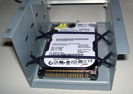

For 2.5" drives, I go to REI and buy some shock cord. Run the cord through the 3.5" drive bays and tie a knot. twist two together to make it tight for a 2.5" drive and slip it in.
Like this:
I think it takes about 2 feet of shock cord, it's like 10 or 15 cents a foot.
On an SSD you can use velcro too. This works for mechanical drives as well, and will essentially eliminate all the annoying seek noise some drives have.
