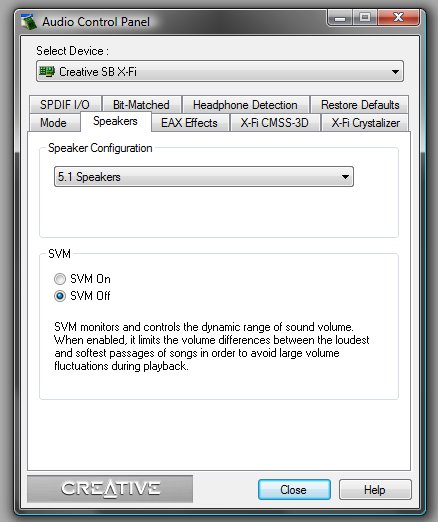

i've got an x-fi xtremegamer hooked up via analog plugs to an onkyo 5.1 system. all speakers show up and work properly in the speaker selection screen...but i cant seem to find where to set the damn crossover frequency.
anyone got any ideas? cause i'm all out.

yes, i have tested the sub indepenantly. it is configured correctly in both connection to the amp/tuner, as well as connection to the PC. it works when i play back my ipod through the amp/tuner. it does not work when i play audio through WMP, or games on my PC.

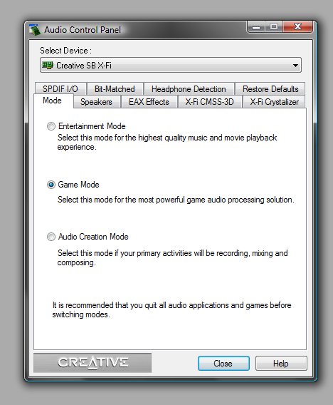

that's pretty much all the configuration i have. i've seen screenshots on creatives site of VASTLY more configuration options..as in i can do specific things in game mode like "enable bass redirection". but i cant figure out where the fuck i'm supposed to be able to configure that kind of stuff.
