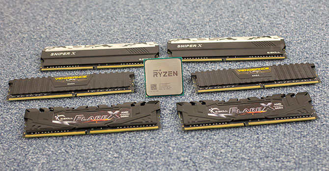

That's not the issue, the RAM works. But you want the RAM to be fast and low latency. 2400 is not fast, and stock timings usually are never low latency. So there should be plenty of room to optimize. See e.g. following guide for what that is about:
