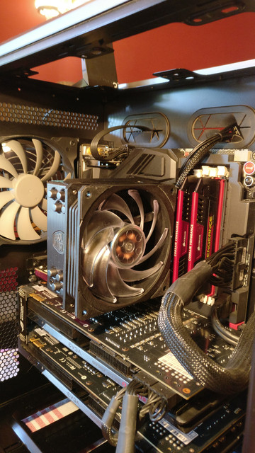

Went through all your recommendations and based on them, product availability and what PCPartsPicker.com was able to show me about their positioning, finally settled on the Hyper 212 RGB Black Edition.
Installed and working great!
Marking this thread solved, repping and closing (if possible and allowed).
Thank you all for reading and esp. aigomorla and crashtech for your help. You made a complex issue, straightforward.
