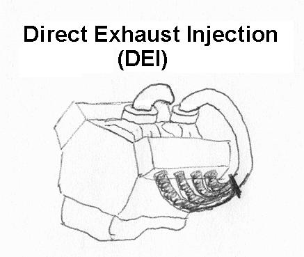

The best modification to engine efficiency that you can attain:
