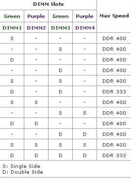

Alright yall, ive been doing a lot of research lately about running 4x512 sticks of ram. I came to the conclusion id go ahead and get a second set of 2x512 sticks of GeIL Ultra DDR500 ram , same as my other. I also have a venice 3000 which can run 2t timings at 200mhz. I realized that i was actually already running my 1gig at 2t timings so i fugured i would more likely see an increase in performance than a decrease. So i threw in the extra sticks and my timings (2.4.4.7) stayed the same and i switched the speed back to 200mhz like your supposed to be able to. However, my 3dmark03 score dropped from 6168 to 5500 and my fps took a massive hit and i started getting hickups in bf2 when before i hadn't. I was wondering could it be my motherboard? Its an MSI Neo2 Platinum which is supposed to run 4 dimms dual channel and says it is but i see no difference between setting speeds at 200 and 166mhz. Could it be the chipset on the board? Might it be that since it isn't that new, it might not be able to take advantage of the Venices memory control? Please help!
