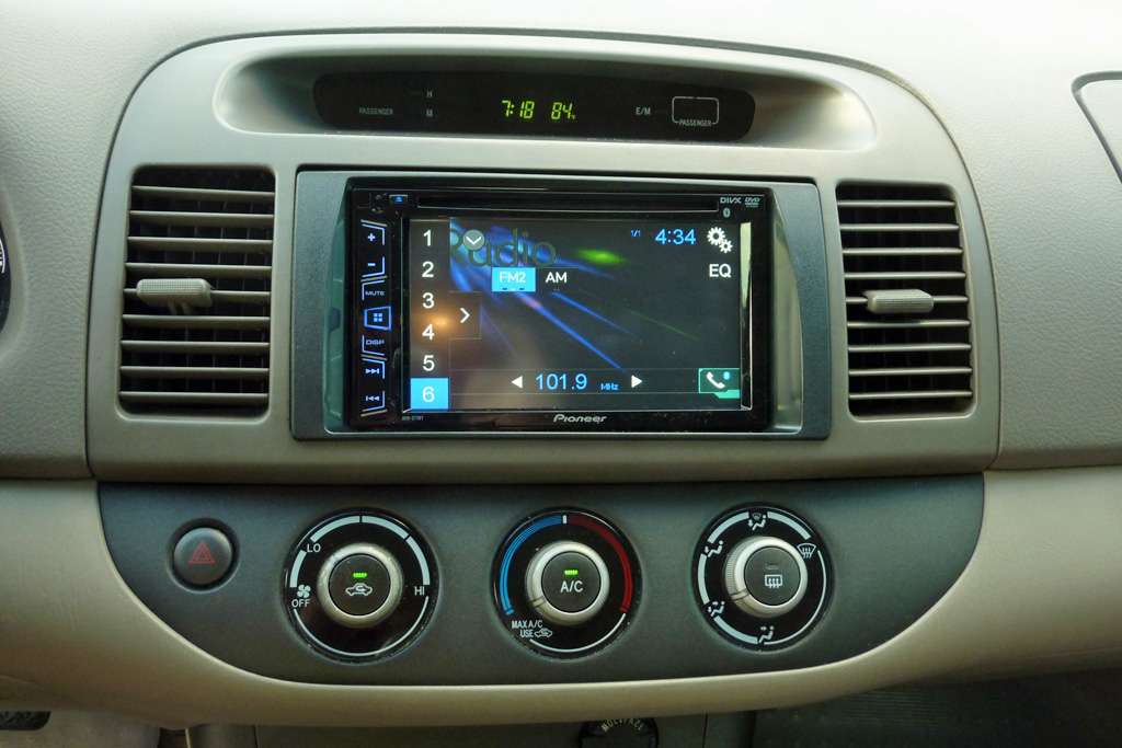

Just did same for the 05 Camry:
Costs:
head unit $170 (Pioneer) bluetooth, no nav.
camera $85 (Pioneer)
dash kit $20
steerg wheel controls $40
"in Drive" DVD adapter $30
TOTAL parts $345
Installation $210
TOTAL $ 555
Oddly, an 08 Accord requires a $200 dash kit....ouch.
