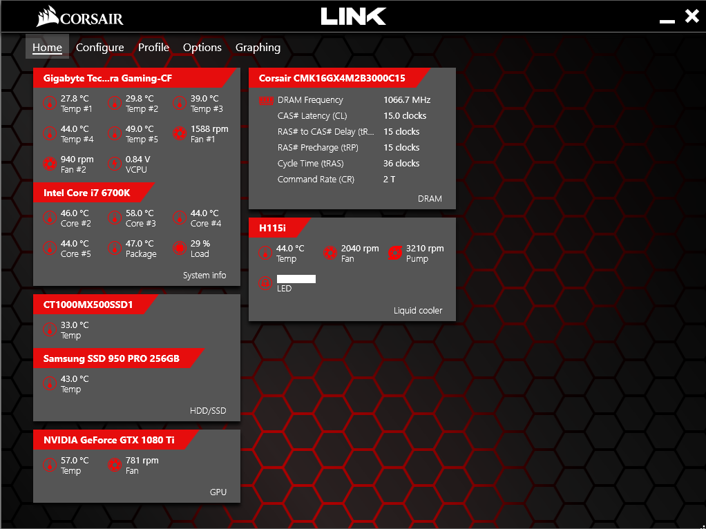

Yesterday I was gaming and suddenly fans spun up hard...Checked temps: 70-75C
Ran game again today for 15 mins got these temps...
Something is happening to this cooler, no? Needs to be replaced?

It's most likely your pump isn't working properly. It probably would be good to contact their support team / RMA department.

Yeah, I am thinking you are right, because the coolant temperature always stays too close to the CPU temperature. I've seen it go past 50C

Make sure air bubbles aren't preventing your pump from priming too, I did a build in a Define R5 that placed the radiator in the front intake which meant it was below the pump\block. It had this issue from time to time and I eventually relocated it.
If you halt all fans can you hear the pump working at all?

It does sound like it's not flowing, my H100 (dual fan 120mm) listed coolant temp never gets above the high 30's C, even after running handbrake for hours on end. Interesting it shows an RPM, the priming idea is a good one.

Reseat the cooler, let it sit long enough for all temps to return to ambient. Hitting 100c in one minute is really fast, even if the pump isn't working. Is your radiator caked in dust? It may be a dumb question, but have you confirmed the fans on the radiator are working?
