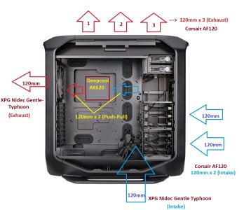

Hello,
I'm currently setting up my Ryzen 5600x based rig inside my Corsair 780T full tower case and wanted some input regarding the fan layout of the case. I'll be using a Deepcool AK620 CPU Cooler in the case and this is what I have planned as the case fan layout:
Front: 2 x 120mm (Intake)
Bottom: 1 X 120mm (Intake)
Top: 3 x 120mm (Exhaust)
Rear: 1 x 120mm (Intake)
Deepcool AK620: 120mm x 2 (Set as Push-Pull configuration)
Diagram (Case can take both 120mm and 140mm fans):
Now my question is should I install 3 x 120mm fans on top or should I go with 2 x 120mm fans instead?
Also, is it going to be better if I fit 2 X 140mm fans in the front compared to dual 120mm fans?

All looks OK to me except for one item. As you sketch above, there is an air flow capacity imbalance towards more exhaust than intake - a so-called "negative pressure" setup. Personally I prefer a small positive pressure (more intake than exhaust capacity). You can achieve that by switching to a pair of 140 mm intakes on the front. In fact, the web page for that case suggests it comes with 140's in front by default.

Switch the Corsair AF120 with the Nidacs.
The Nidacs were designed for restrictions, and will serve a much better fan though obstacles as they have the top static pressure.
I would get Noctua's instead of Corsair fans also, especially for the top ones.
Fan's die exponentially faster when in the horizontal position.
Noctua's IMO seem to last longer then most fans when put in that position.
So Nidacs => best fans when you have restrictions, like a heatsink / radiator / a bunch of hard drives.
Noctua's => best for quiet, or when in horizontal layout.
Top mention:
I really like Artic Cooling P series.
These can easily be swapped out for expensive noctua's, although they may only have about 80% the life value of a noctua, but easily cost half a noctua.
Reactions: Sam25

Sam25
Mar 29, 2008
1,720
29
Thank-you so much everyone for all the input, really appreciate it.
I have taken @aigomorla 's advice and changing ALL the fans to Nidecs (120mm). Arctic P-series fans are not currently available here in India unfortunately.
The fan-configuration looks like this then:
2 X Front - Intake
1 X Bottom - Intake
3 X Top - Exhaust
1 X Rear Exhaust
Deepcool AK620 CPU Cooler- Push Pull (w/ default Deepcool fans)
Now, since the above fan config has slightly more exhaust vs intake is the negative pressure in anyway harmful?
I have been running this same fan config (negative pressure) for the last 6 years on my Ryzen 1600X setup in the same case (Corsair 780t Full Tower) with Corsair AF 120 or 140mm fans without any problems. My CPU temperatures while gaming don't go beyond 60C and HDD's all stay in the mid 30's. Also, GPU (Asus Dual Radeon RX6600) hovers around 59-62C when gaming. This is in India where I am at presently and ambient room temps without the AC running is about 30-35C normally (barring winter months).

Exactly as Tech Junky said. Small negative pressure has NO direct impact on cooling. It means only that some room air containing dust may enter the case without going through dust filters, so dust may accumulate slowly inside your case. Lots of that can interfere with heat removal. But periodic light cleaning can deal with that.
Very difficult to hold any meaningful amount of pressure inside a case without using window sealing foam, or some form of rubber in every corner of your case.
So do not worry about pressure.
The only time it plays any role, is probably when you have positive pressure fed though a HEPA filter so you can keep your internals dust free in a high dust environment.
