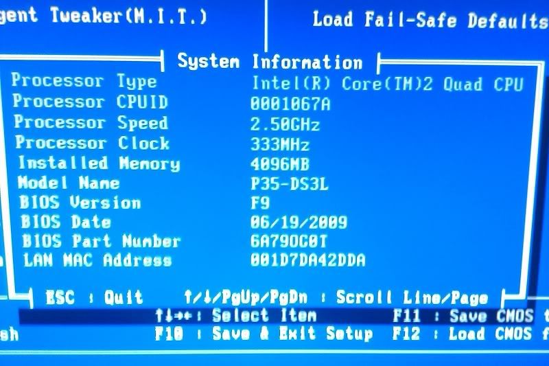

Coretemp,HW monitor, task manager aren't showing that i have 4 cores

I would say thats a issue for sure. Does your BIOS show the correct CPU on bootup? Does the BIOS version you are running support that CPU|

Another pic
http://i9.photobucket.com/albums/a61/emblemchaos/Phone/IMAG0097.jpg

emblem, because your ss shows device manager with 4 cores indicates this is a windows config problem. Are you familiar with BCDEdit?
Run BCDEdit from a cmd box with Admin priv's and enter the following
Code:
bcdedit /set {current} numproc 4
Reboot
Code:
Reboot
Awesome, that worked.
Thanks bro.
