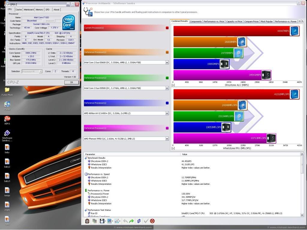

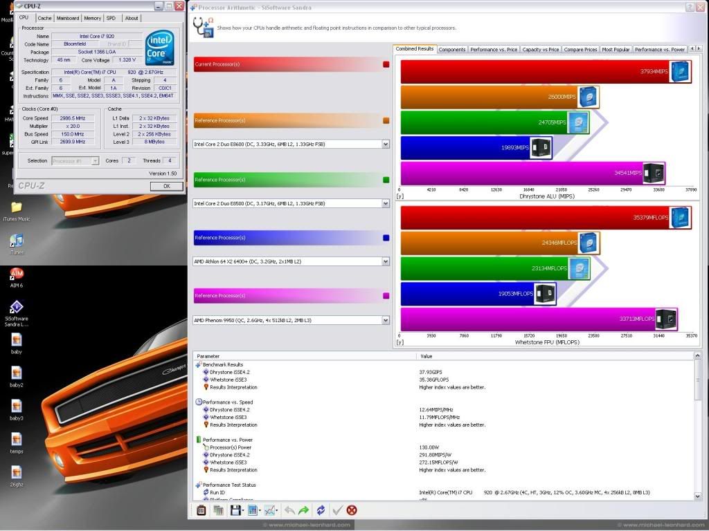

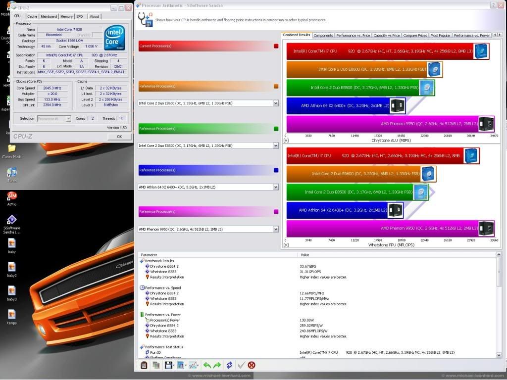

Core I7 920 With 2 Cores / 4 Threads
IntelUser2000
Oct 14, 2003
8,686
3,787
Clarkdale, not Havendale.
Anyway either CPU-Z is wrong at reporting data or its not 2 core Core i7, because 2 core should be 4MB L3.
palladium
Dec 24, 2007
539
I believe the OP disabled 2 cores in BIOS to give an estimate of what Clarkdale can deliver.
Rick James
Feb 17, 2009
386
Thank you pall. Exactly what i did. This is a VERY rough estimate but even compared to an E8600 @ 2.66ghz is amazing.
