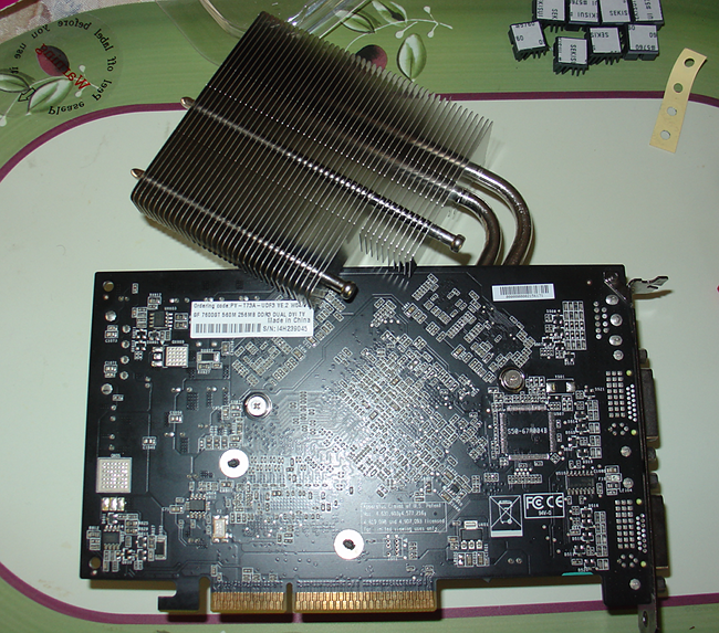

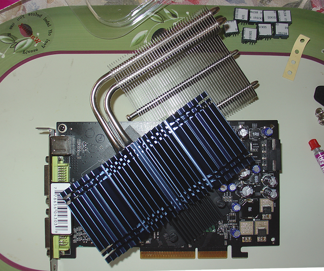

Fitment (front)
Fitment (back)

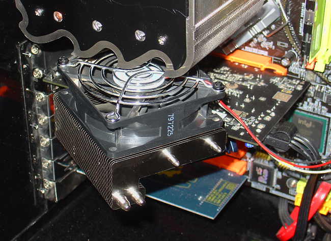

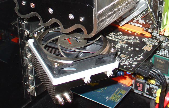

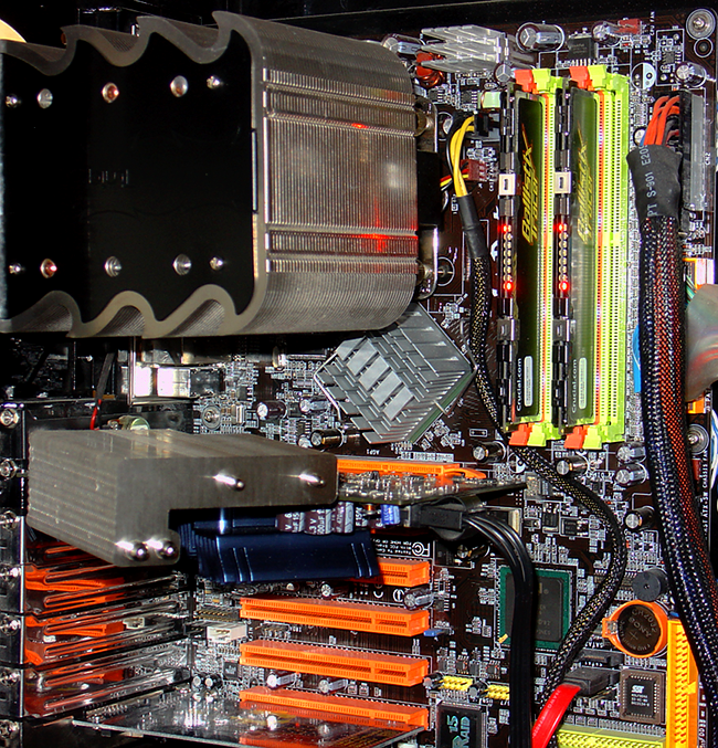

Installed (angle 1)
Installed (angle 2)

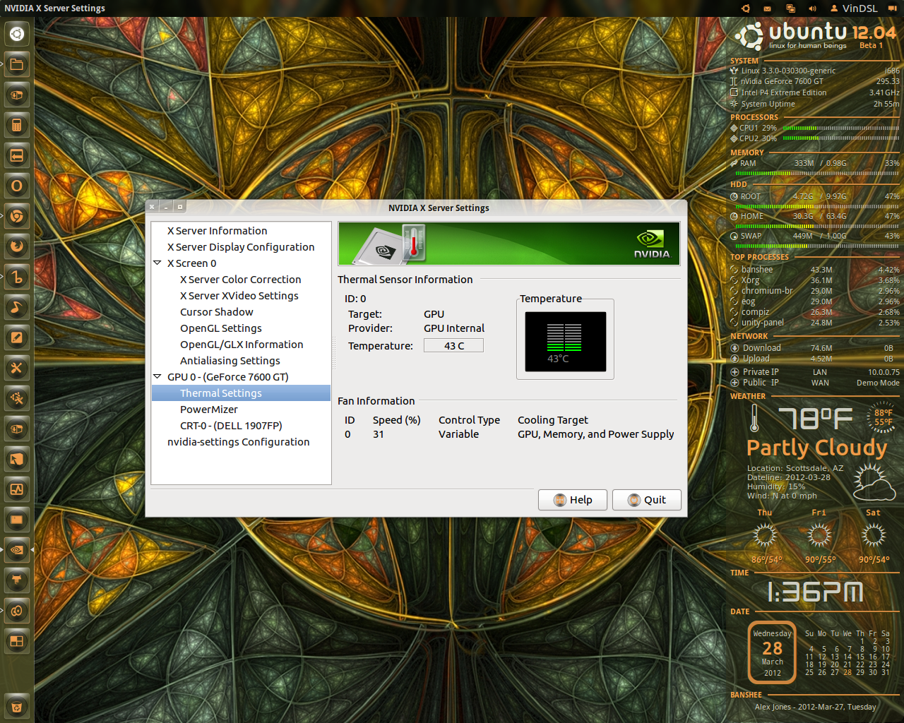

Results (nVidia X server)
Bottomline: Works like a champ! Identical temps, compared to the OEM heatsink.

Here are some snappies...
Fitment (front)
Fitment (back)
Installed (angle 1)
Installed (angle 2)
