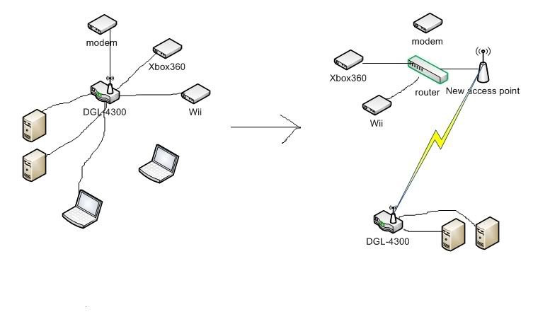

My current setup consists of a cable modem going into a wireless router. The wireless router is actually maxed out port wise (DGL-4300) and unfortunately my desktops are on the other side of the apartment so I have cables that run all the way across. Here's what I'm thinking, any suggestions?
New switch and access point.
Cable modem -> new router.
- new router would be used to connect Wii and other devices next to modem.
new AP -> new router.
- I'll use this to extend the wireless signal to DGL-4300 i currently have across the apartment
DGL-4300 wireless to new AP
- I'll plug the desktops into to DGL4300 which will be wireless connected to the new AP.
Will that setup work? I'll probably spend no more than $130-$150 on the new AP and switch.
Edit: I guess the new switch should be router, not just a switch, my mistake. changed
don't hate me, this is not how my typical visio drawings look, but this is what i'm thinking:
http://i7.photobucket.com/albu...Tarrnat64/new_setp.jpg
I'm not sure if I'm understanding your setup correctly, but I assume your wireless router is doing all the routing. If that's the case, it'd make more sense to keep the router next to the cable modem and then put the switch at the other end.
If you find you're needing to boost the wireless at the far end, you can add another access point at the switch for that spot. To combine that into one unit, buy a second wireless router, and turn off its routing functions so that it functions as a basic switch and wireless access point only.
ie.
Cable modem --> wireless router ---------------------> switch --> wireless access point
Or
Cable modem --> wireless router ---------------------> wireless router #2, but with routing turned off.
right now my wireless router/switch does all the router (DGL-4300). What I want to do is move that DGL-4300 to another area of the apartment and have it connect to the new wireless access point. other laptops should connect to the wireless access point too I'm assuming, and not the DGL-4300. The DGL-4300 will connect to the AP, and then my desktops there would just plug right into it for internet access.
This is so I don't have to run cables all the way across the room. I wanted to add another switch where the access point is for any devices there that need to be directly plugged into something for internet access.

With that wireless AP put in, there shouldn't be any major problems with that setup, right?
So I was still confused. I didn't realize you wanted a wireless bridge. You might want to get two WDS access points if your current one doesn't already support it.
Or if routing is easy, the cheaper option would be to buy some wiremold and CAT5e cable. 100 ft of CAT5 goes for 10 bucks at Monoprice. Wiremold is expensive, but the other option is you could just try some cable hooks for a few cents each. Run it along the edge of the wall. The cable can be purchased in a colour similar to the wall. For example, most of my recent cable purchases have been white, since my baseboards are all white.
P.S. Your diagram has a new router and new access point. Why not just a wireless router?
If I get a new wireless router I would have to make sure it supports bridging right? The DGL-4300 supports bridging but I haven't really been able to see if everything works like it should.
So getting rid of the new router, i should be able to get the 4300 to connect to whatever wireless router ends up being used, right?
You have it backwards. The DGL-4300 cannot work as a client-mode wireless bridge, and its WDS is lacking. I suggest using it as the router and wireless AP in the first location by the modem, and adding a client mode wireless bridge in the second location.
If you stick with standard-g, you can do this with a single WL-520gU or WRT54GL, among others.
If you want to look ahead a bit, you could consider a WRT150N or something else, but the prices jump quickly, and getting two more expensive devices would generally exceed your budget.
Thanks for the heads up on the DGL-4300. I thought maybe it could but if it'll work the other way around that works for me too. I'm looking for reviews on the WL-520gU, I'm undecided about it.
Looks like the Asus is supported by DD-WRT, so I may be in luck for what I'm trying to do: http://www.dd-wrt.com/wiki/index.php/Asus_WL-520GU
Haven't used their products and I was bent on the WRT54G so now it's just up in the air. Never heard really any bad things about the WRT54G.
OK, I've decided on the Asus WL-520gu I think. I've been searching the forums and it has been recommended a lot. I will take that and run DD-WRT since there's really good documentation on the setup process.
