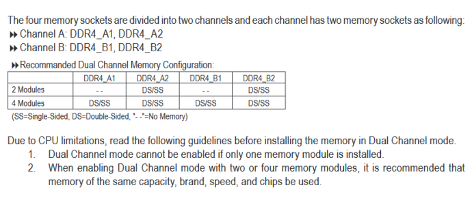

Everything was assembled and all plugs are exactly where they need to be. It absolutely would not even boot to the gigabyte screen. After doing a little reading on the exact motherboard, apparently it has some slight issues with using four sticks of memory so I decided to test each stick individually on all four slots and verified that all the sticks of memory did work so I ended up just using two sticks to get everything up and running.

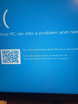

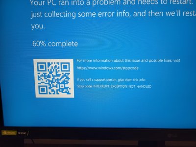

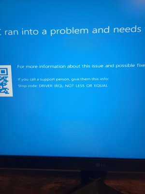

Some of the errors.... they come up different each time...
Kmode exception not handled
Kernel security check failure
Driver IRQL not less or equal
Interrupt exception not handled

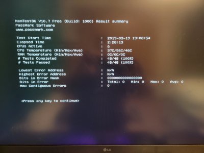

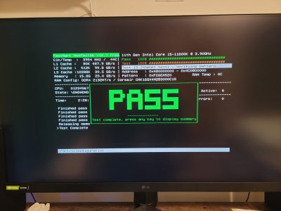

I would strip it down to only CPU and the memory modules you want to use, boot to memtest86 on a USB flash drive and see if it's stable. I always do that before an OS install on new hardware where stability is not yet established. If you get memory errors, consider the OS install toast and gain stablity, then reinstall, not overtop of itself, rather a clean install where there isn't the risk of corruption.

I tend to agree that this sounds like a memory related issue, based on the BSOD messages. Definitely run Memtest.
I had it running when I left for work tonight. It passed the first 2 tests and was 75% through test 3 and didn't show any errors.... I'm stumped. I do have a new 750 watt Corsair PSU coming just to rule that out

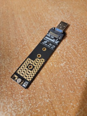

This is a M.2 to USB converter. I only use it when I need to check things on a M.2 drive so I don't have to take my PC apart. I put the M.2 in the adapter and then plug it into the front USB of my rig

In2Photos
Mar 21, 2007
2,497
2,723
Have you tried connecting it to the rear USB ports instead? Did you also use the Windows 10 USB install in the front ports? Have you tried the rear ports for that?
In regards to M.2. M.2 is the form factor for the drive, like 2.5" or 3.5" for disc drives. NVME refers to the interface type. NVME uses PCIe. If the drive has 2 notches where the contacts are located it is a SATA drive. If there is only 1 notch it is an NVME drive. None of this matters to the problem you are having but just want to clarify nomenclature. I assumed that the M.2 was an NVME drive since the build is relatively new.

I'd try a different boot device, just to be sure. And by that I mean the drive plugged directly into the board with no adapters.
The M.2 is plugged into the board. I've tried all 3 of the M.2 connections with 2 different drives. The adapter thing is just what I used to check the drives on MY rig (not my daughters) to make sure they were working
