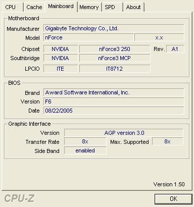

This is the mainboard im using which is fairly old.
http://i135.photobucket.com/al...hateverness/UO0140.jpg

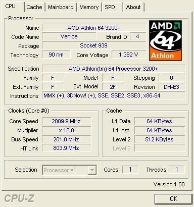

and a little about my cpu
http://i135.photobucket.com/al...hateverness/UO0142.jpg
So the problem im having is i want to know what video card options i have with the main board im using now.

Wow an nforce 3 board. Times have gone real fast fosho.
I guess finding a 6800GT/X800XT would be quite an upgrade over the FX5500. AGP is quite dead so your options are limited to few available cards that are still selling for retail (expensive), or buying ones that are used. Id say try looking for the following cards (performance of the cards increase as you move along the list)
9700/9800pro, 6600GT, 6800GT, X800XT/XL 7800GS AGP, X1950PRO AGP, HD3850 AGP (the last three cards are probably overkill for your system and way too much $$$ to justify upgrading a ~6 year old system)

and the single core processor is fine for now and i can possibly upgrade later to whatever i want with this mainboard?

Check to make sure you've got an ATX motherboard in there already (how many PCI slots does it have?) and everything should fit fine. And what single-core processor are you talking about? The two options I presented are an AMD Phenom II X3 720 (triple-core) or an Intel e5200 (dual-core). Either way a considerable upgrade from your current system, I think you'll be satisfied whichever option you choose (and you could even go with the 4830 video card to save more cash and upgrade just that part in a year or two when it starts chugging).
