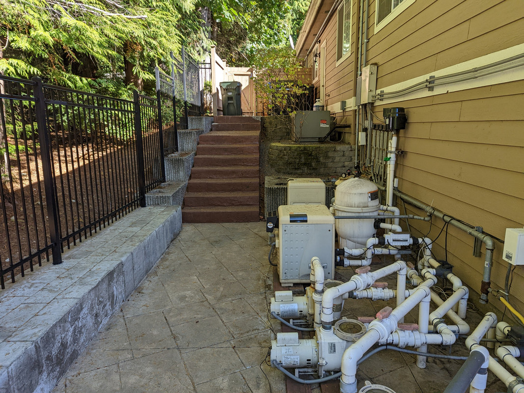

I was tasked with removing a large hot tub in a very difficult location, and got started on it yesterday.
The only access was from a common area behind the home, and through the bottom of a dry pond. I'll bail the concrete out of there with the big excavator, track it over to the edge of the pond, then re locate to the bench above it and load it out.I'm guessing (3) 12 ton dump truck loads. Here is the access, over the 18" high wall and across that lovely lawn.
I set the 6x6 T1 steel sheet for a landing pad, and plywood and a 4x8 to lift myself down with.
I jumped down there and then spun the machine 90 on the steel sheet without dragging a track over the edge. Then I set form plywood on the lawn and headed for the pool deck.
Here I have passed the hydraulic demolition hammer down and am picking the steel sheet off the grass before it does any harm.
It is very narrow passing by the pool. The deck has a continuous drain down the edges, this means it is not supported for about 8" and I won't track on that. I had to set one track on the curb on the left and the other on a 4x8 on top of shipping blankets to make sure i don't mar the pool deck.
You can see the hot tub there, it is massive and raised up, I have to demolish my way into it to make the corner at the end of the pool.
I think I found the leak! :D
I figure 2 more full days of hammering, and a couple more to clean it all up. I have the big machine down in the pond below and pulling the material out as I go.
BTW, this is the other access to that area. Nope!

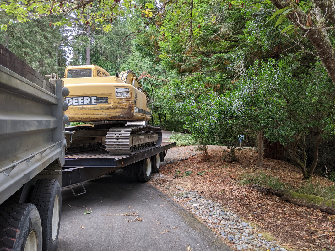

No! That machine is part of a set. If I get a bigger excavator, then i have to replace this 20 ton tandem tilt trailer:
It is downright sporty to tow around town and into tight places. This job, I had to hit the trailhead just right and not take down any tree limbs, for example.
The truck can handle more weight, but I'd have to get one of these 3 axle pigs. They are nothing like my trailer above, they scrub hard in tight turns and take a mile to get backed around in a new direction. In contrast, I have picked up the free end of this trailer and dragged it around where I needed it.
3 axle 30 ton Titanic Land Barge
In Washington they follow the federal axle rules. That's 34,000 on any two axles.
The excavator is 28,000 as equipped. The trailer is ~10,000. I run with about 6000 pounds of tongue weight to be on the safe side. Ponder 6000 pounds of tongue weight :)
