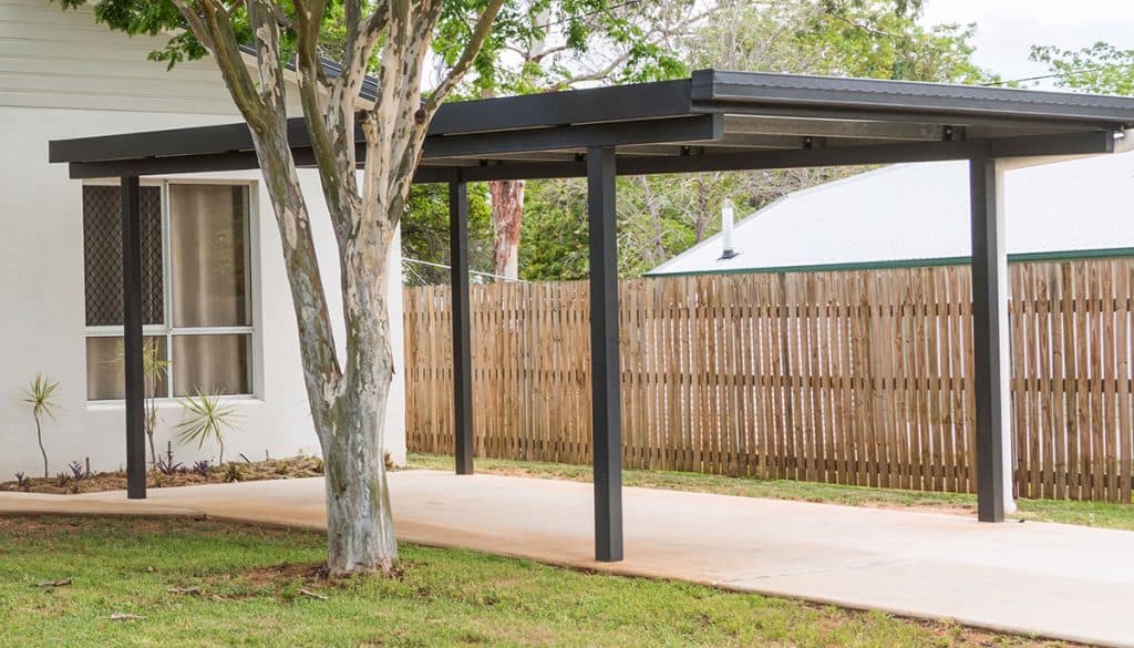

If you're going through this much work - why wouldn't you just make a custom four post carport? Wouldn't matter if there was a slope - you'd just have taller beams on one side than the other and set your minimum height to the vehicle based on the high side.

Those are really hard to stabilize without the posts sunk in the ground, a system that will always fail. I rebuilt 192 that were done that way.

Oh I 100% agree he would still need to pour concrete feet for it, but no need to pour an entire length of level surface I guess was my mindset.
