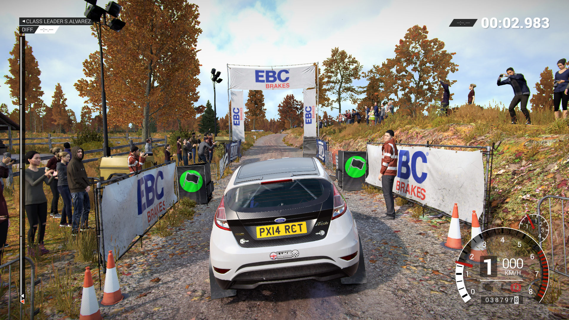

We all have seen how AMD cards are so much faster than NVIDIA counterparts in Dirt 4, specifically when using CMAA as the AA method. While the situation becomes reversed with the use of MSAA.
I think the reason is revealed by the testing done by ComputerBase.de, they discovered that treed don't render correctly with AMD cards and CMAA, they a checkerboard/grid pattern appearance. The issue only resolves itself under high level MSAA like 8X MSAA, and NVIDIA cards don't suffer the same problem.
CMAA: (click to enlarge, look at the tree to the right of the center road sign)
8X MSAA: (click to enlarge, look at the tree to the right of the center road sign)
https://www.computerbase.de/2017-06/dirt-4-benchmark/#bilder
This is what causes the huge disparity in performance under CMAA in AMD's favor. Using 8X MSAA reverses the picture and NVIDIA cards are now faster. Here the GTX 1080 is always faster than Vega 64:

OP, you're missing the full context and analyzed the issue wrong.
This is a known problem with the EGO engine version 3.0. While Dirt Rally has still provided some huge forests with this problem, there are only very few trees in Dirt 4 that are affected by the problem.
The problem exists in Dirt Rally as well, and in there, a lot more trees are affected by this bug, yet AMD GPUs do not run faster than NV, they tend to run worse in fact.
There is a major issue with performance loss on AMD GPUS with 8x MSAA, it is not just affecting RX Vega, but all the other cards.
https://www.hardocp.com/article/2017/08/08/dirt_4_real_gameplay_video_card_performance_review/10
No AA vs CMAA: Radeons take a very small hit.
>CMAA is only 2% from No AA here, hardly any difference.
No AA vs 8x MSAA: Radeons take a huge hit.
>No AA is 74% faster than 8X MSAA, again showing 8X MSAA is a bigger burden on Polaris.
You can look at GTX and CMAA & MSAA effects on it as well:
https://www.hardocp.com/article/2017/08/08/dirt_4_real_gameplay_video_card_performance_review/6
Basically CMAA runs identical performance within margin of errors on Radeons or GTX, while 8x MSAA runs much worse on AMD than NV (both lose perf big time though).
There is a graphics glitch with CMAA on some trees on Radeons. This bug exists in the engine since Dirt Rally. Nobody at Codemasters must have noticed.
The speculation in the OP is therefore proven wrong, CMAA is not the reason why AMD GPUs run Dirt 4 better because CMAA does not drop performance much (2-3%) for there to be a major difference between NV or AMD GPUs.
AMD GPUs run it better with No AA, CMAA, MSAA 2-4x, while they run it worse with MSAA 8x. It is not an RX Vega specific issue. It seems to be an optimization issue across the board for AMD GPUs with 8x MSAA.

You guys really really lack any sort of attention if you can't spot the difference, just enlarge the first picture, and look at the tress to the right, the most center tree appears pixelated like this:

I don't see it as an optimization issue, at 8X MSAA the IQ bug disappears thus causing performance drops. The reason AMD GPUs run the game so much better with no AA, CMAA, and 2X/4X MSAA is because the IQ issue is still there, and tress aren't rendered correctly which makes the Radeons run the game faster. At 8X MSAA they render correctly slowing the performance down.
The source you quoted was very specific on it.
>As long as no MSAA is used as edge smoothing, the trees on Radeon graphics cards are not displayed correctly and are provided with a grid-like pattern.
There is no visual difference between the tree with 4x MSAA vs 8x MSAA. Your implied 8x MSAA being massively slower because one tree in the forest isn't rendered properly is preposterous. No trees are rendered incorrect with 4x MSAA, yet Radeons are still faster.
Again, to clarify:
PhoBoChai
Oct 10, 2017
119
389
This is 8x MSAA
4x MSAA:
CMAA:
The problem is non-existant with 4x MSAA. Yet Radeons are still faster.

It would be funny, if both screenshots were taken using Nvidia GPU.
How cute, if you bothered to read the article, it clearly states AMD's IQ issue with Dirt 4, whicb presisted in Dirt Rally as well, takes half a dozen pictures of it, and proceeds to explain it in detail.
And yes, even at 8X MSAA the problem still exists though only in a minor form.
