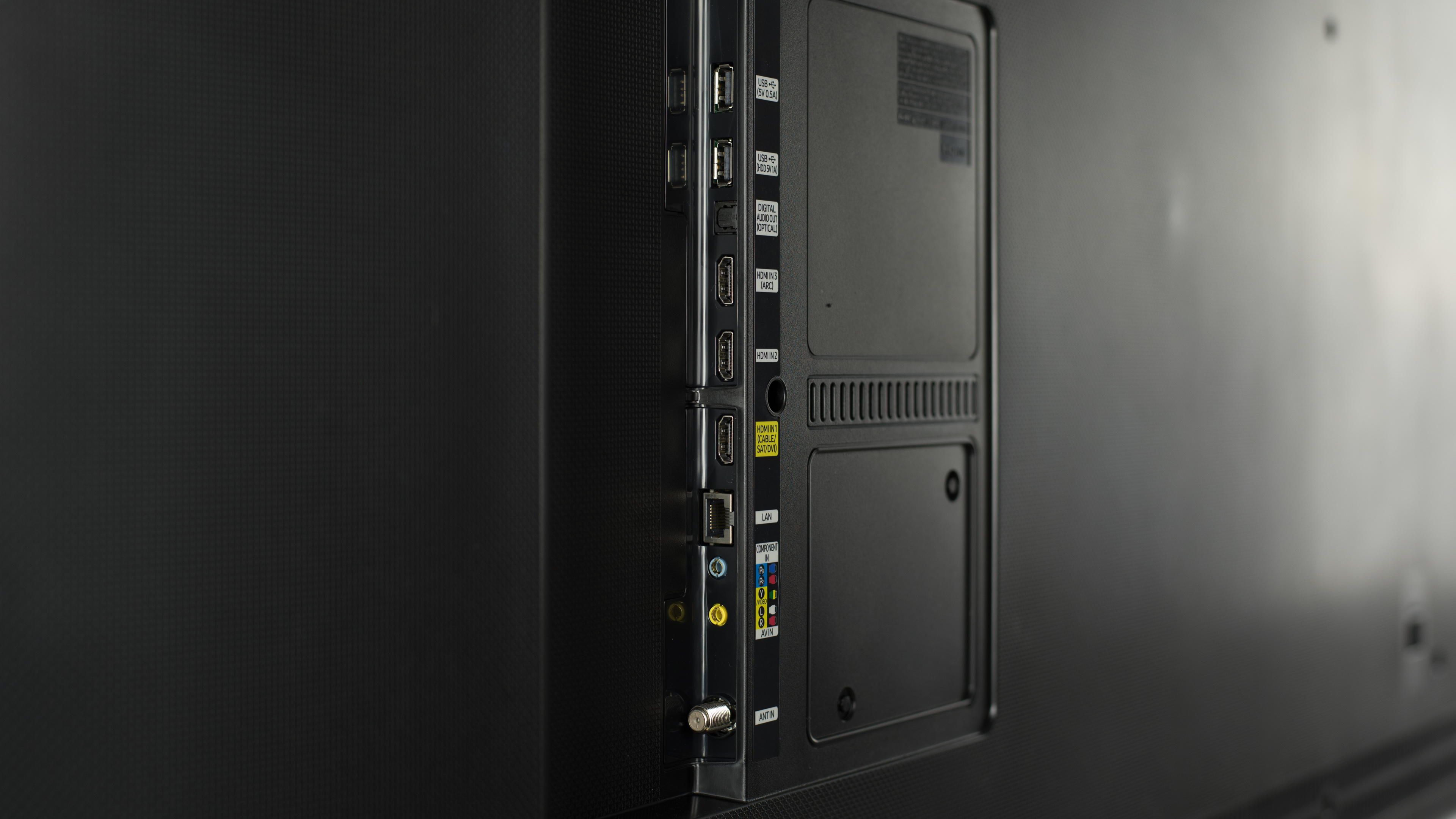

I have no plans to upgrade my older Onkyo receiver that doesn't have HDMI, but we're looking to get a 70" tv soon (perhaps a Samsung UN70KU6300). I read that going with component cables would be just as good even with 4K? Most activity source will be from a FIOS set-top box using component cables. I was looking at this pic and wasn't sure why there are only 2 connectors for component... I'm used to the 5 cables... what is this sorcery?

component wont carry 4k
when you get a 4k source, connect it right to the tv
run an optical back to the receiver
you are most likely only going to get 2.1 sound that way as 99% of TVs wont and or don't pass 5.1 or higher over optical like that
