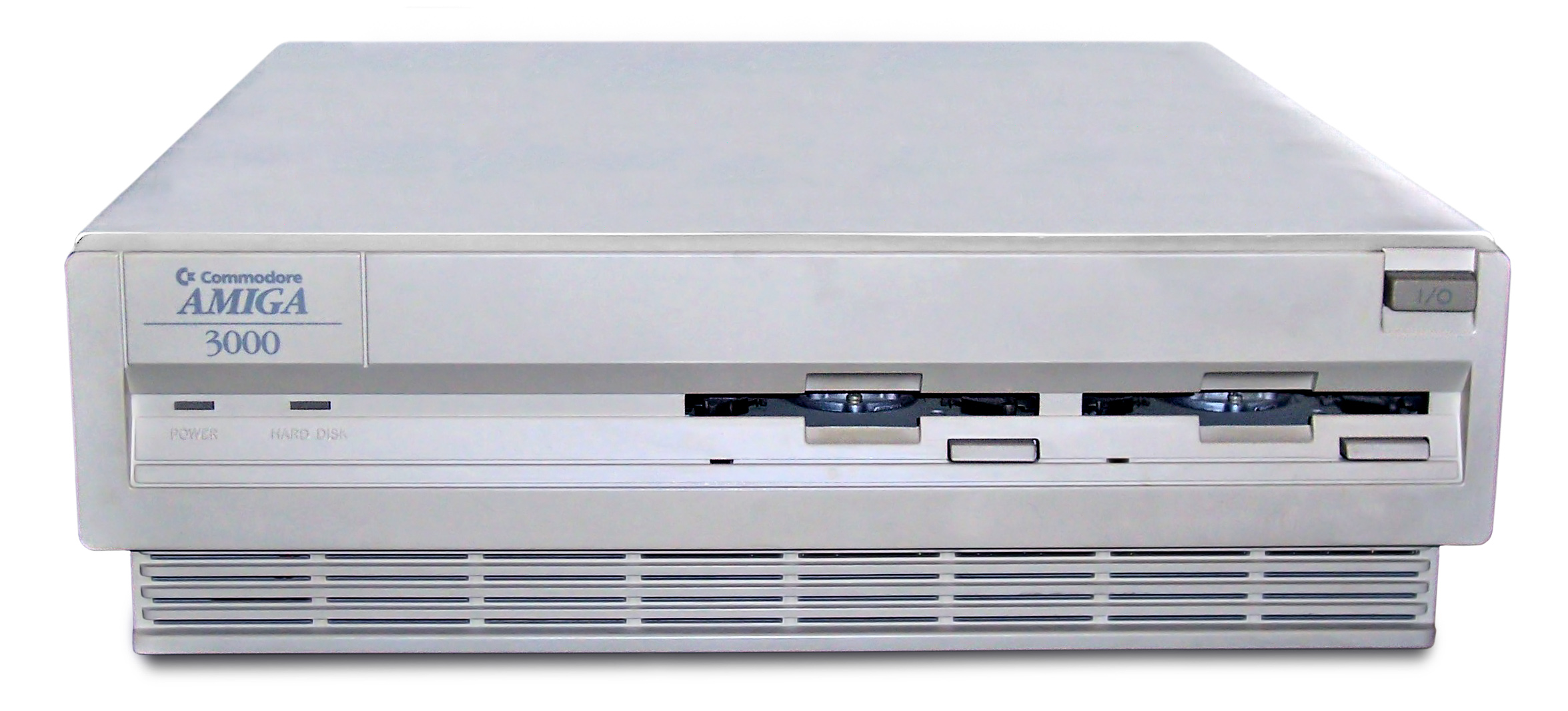

I also posted a thread about this on an Amiga forum and one idea that was suggested to me was to somehow make it look like the Amiga 3000 chassis with everything appearing more integrated.
What he meant was to seal the gaps around the drive bays and led cut out and then smooth it over and paint it.
Seems like an interesting idea if it's feasible, but I don't know how you would mod plastic to look like that.
Is there some kind of epoxy or putty that you could use to make that work?
