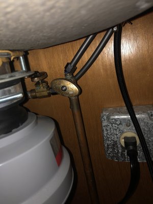

I have done battle with this before and now I need to change it.
First the valve no longer turns
Second it is way to high as in the pipe needs to be shortened for a new faucet to connect to it.
Is there a compression style shut off vale for a cold water line for a kitchen sink that is threaded on the other end? Some kind of pex type valve.
My plumbing skills are weak I need this to be easy as possible.
I am not afraid to cut the copper pipe down. I am thinking if I lower it about 6 inches it will be far easier to work with.

yep. what greenman said, depot should have a regular compression style as well if you don't like sharkbites like greenman. haha. You do not need 2 valves there. remove the one for you dishwasher or whatever is on the side. . . . .
wait. is that just the hot side of the sink? one hose from faucet going to each valve in the picture? if so, just get a regular valve, not one with 2 outlets.

It’s the left side, the cold line.
Hot line is right next to it. Good chance I’ll lower and change that valve too.
Thanks guys.
3/8th is the normal out correct?

the faucet lines should be 3/8.
The 1/4 turns are ball valves vs. a needle valve. Ball valves are more reliable and generally don't have stem leak issues.
