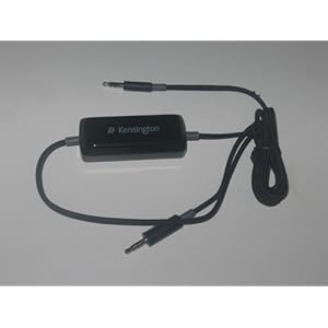

A cheap way to clean up the sounds in your headset is with this thing:
Kensington Noise Reducing Car Audio AUX Cable for MP3 or SmartPhone, including iPhone 4S - $13.54 & eligible for FREE Super Saver Shipping on orders over $25

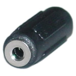

Just use one of these female-to-female adapters to enable its use with your headset:
SANOXY 3.5mm Stereo Coupler, Female / Female - $0.74 free shipping
http://www.amazon.com/SANOXY-3-5mm-Stereo-Coupler-Female/dp/B000I963FE/ref=pd_sim_e_45
Nice bonus is you can use it in your car to eliminate the funny ground-loop sounds when charging and listening through the car's AUX port.
Note: I've used this thing in my computer and my car, works great in either to make everything super clear and totally removes the weird computer/coil whine noises in your headset.

KingFatty
Dec 29, 2010
3,034
The ground loop isolator will remove that noise I heard in your video, same as the sound I fixed on my PC.
