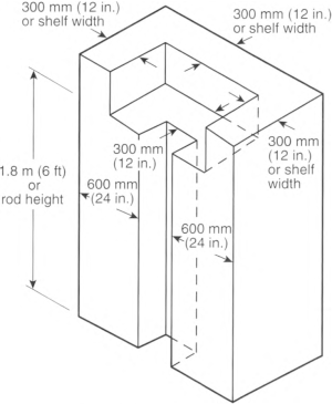

closets have specific requirements for light fixtures. you can not install a track light. It must be fully enclosed. Is there an attic above? It would be pretty easy to fish down to a new cut in box through the wall and into the attic space above and keep the wire in the walls where it should be. NEC 410.16 is the code reference. I am a currently licensed electrician if you have any specific questions. closet.png
