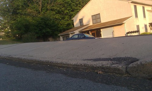

I sort of get what you are saying but have no idea how to implement such an idea. Here is a decent picture I could find of the setting:
You can see its a pretty steep slope and well bellow the street. Like I said, there was never an issue in the past 4 years unti the recent 3 flash floods we had.

Are you positive that the water is coming in via the driveway?
That is a terrible picture :) but based on that alone, it looks like your front yard directs water right into the foundation to the right of your driveway.
That is a terrible picture :) but based on that alone, it looks like your front yard directs water right into the foundation to the LEFT of your driveway.
FTFY
There also may be an issue with water flowing down those stairs.
