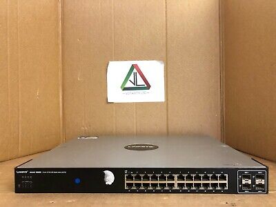

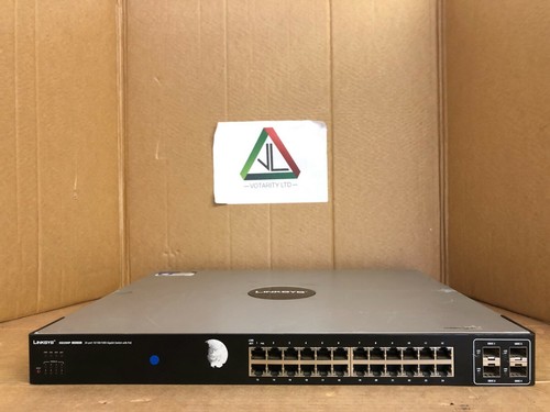

This appears to ship to Greece
Cisco SGE2000P Cisco 24-Port Gigabit Switch + PoE with No Brackets
GBP 69.99 + 19 s/h
Thank you for the link. UK shipments are considered 3rd country deliveries which you will need to add extra taxes and it will probably reach that price x3-x4 times plus 2-3 months waiting time..
