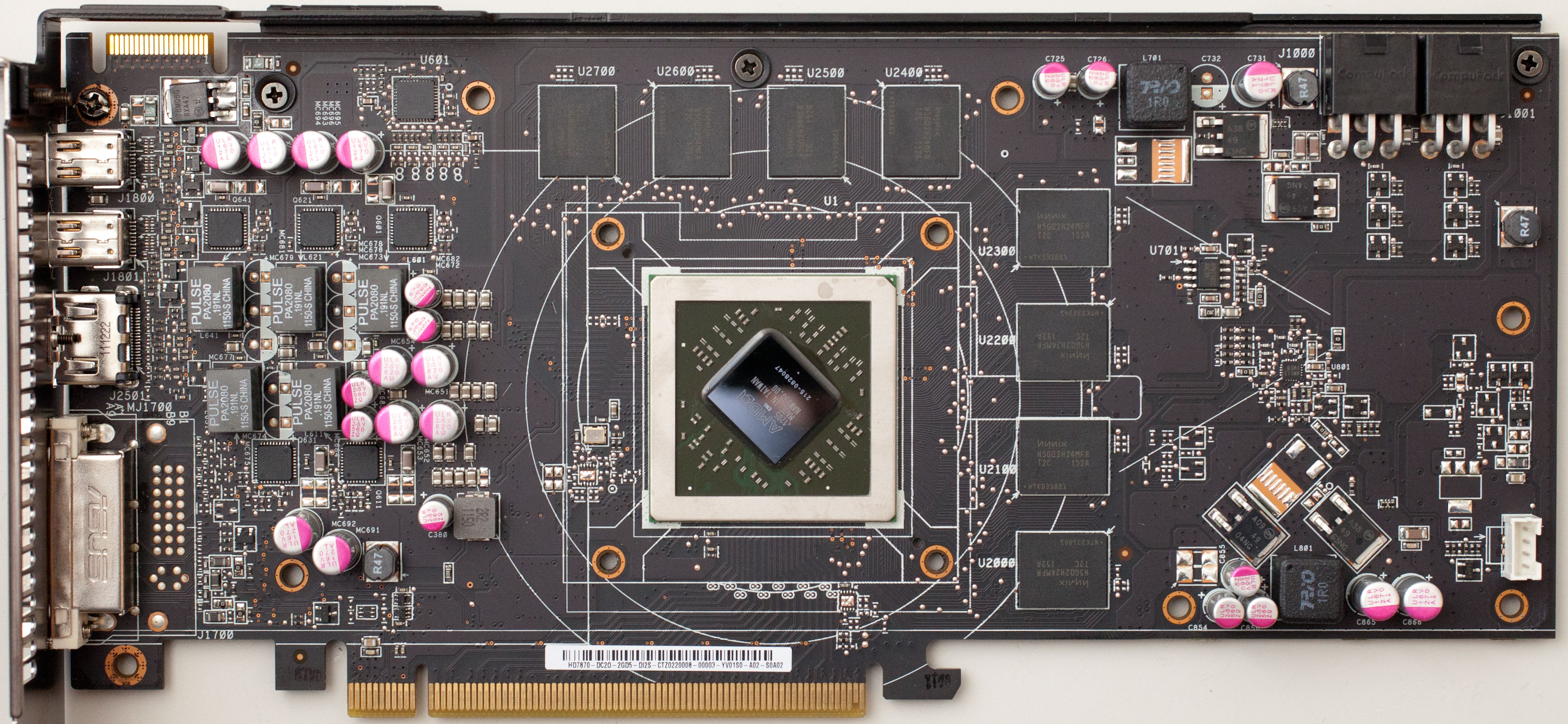

I've been experiencing light artifacting in several games on my new 7870 at stock clock speeds, most notably in Skyrim. I'm considering RMAing the card, though I can't do so immediately. I pulled the card out of my system to have a look at it, and I noticed that a couple of the PCI-E pins seemed "chipped" --
The chipped pins are not lined up. Could these be the source of the artifacting?
Ah, ok. So that can't be the cause, thanks. Anyone have any idea of what's causing the artifacting and how I might remedy it without RMAing the card? 🙁
