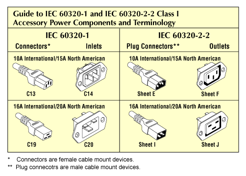

Like this kind of plug? Square type thing.

That looks like the same connector that Apple used on the late Power Mac G5 machines. Like 'RFC Rudel' said, if we're talking about the same connector, it's a standard connector rated for higher currents than the "normal" PC power cables. :thumbsup:

You see that makes no sense.... because my AX1200 doesnt do that..
My AX1200 will outperform my 1600W ultra any day of the week, while having one arm and leg tied behind its back, yet uses the standard type of power plugs.
So tell me why the industry's best PSU doesnt use it...
I havent even seen Enterprise PSU's use that type of plug either.
Yet these other guys do... :T
Im assuming its for the 240V EU standard?
That MAC u showed has a EU plug.
Because after that ultra... i wont buy another psu which uses that type of connectors.

Whether it is "required" or used depends on the load - it's not a "quality" thing, so it has nothing to do with what are the "industry's best" power supplies. You can see the chart in my previous post - your 1200W power supply is under the limit, but a 2000W power supply would be over.
Nope, the late North America G5's had the same connector. I just picked that one because it was the first picture I found showing both the plug and the socket on a G5 Power Mac.

I was referring to electrical cable standards, for 220V some countries require that type of connectors.
Al types of high power devices require big plugs in my country.
Here any imported electrical device must approve electrical certification, and I understand that X manufacturer that want worldwide approval use the standard that fits the product.

As others have said, this is entirely to do with current rating. The C13/C14 connector you're used to is limited to 10 Amps of current. That means, under 120V, you're limited to 1200 watts of peak power (notice your AX1200).
To go beyond that, and be in proper standards, you have to move to the C19/C20 connector, which is the odd connector you're referring to. It's an IEC standard just like you're used to, but its rated for 16 amps rather than 10.
And it's not uncommon in high power enterprise applications at all. Blade Chassis that aren't using DC or 3-phase power (most HP, Dell, and Cisco UCS blade chassis), and Network Chassis (Cisco Nexus 7000, etc), use the connectors when each power supply is expected to supply over 1000 watts of power.
