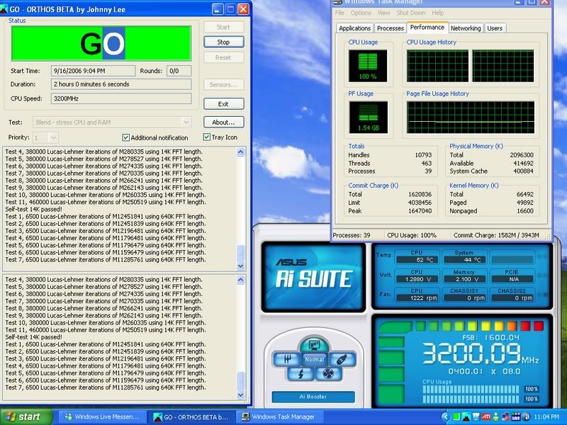

Check out my OC and temps.

I'd say this is a bragging post in disguise. :D Yeah that's a heck of OC and temps look just right. :p Where is your memory at? (frequency/timing)

800@ 4-4-4-10

Nahh not trying to brag at all honestly. I'm guessing anyone with a E6400 and this mobo could get these speeds. Now if I could get 3.6Ghz-4.0Ghz, then that would be impressive. You have a good overclock with what you have and excellent timings. I may be able to squeeze more out of mine tho. I just "set it, and forget it" (hate that commercial!) one time, the first time, and never touched it after that.

wow nice OC on such low voltage. How come your scythe keeps your CPU so hot? I have the infinity and I have
25*C idle with a 6700 @ 3.5 w/ 1.55 volts
45*C load

It's still impressive in that you're still @stock Vcore. I need to give 1.45V for 3.2GHz (P5W-DH). BTW that RAM should do DDR2-800/3-3-3 @2.2~2.3V

Good question and I may have the answer. When installing the SOB it was horribly cramped on my fat aths fingers. I know the top right and the bottom clips are secure but the top teft one was unbelievably hard to connect. Whenever I would pull up on it it would release. I've heard people say all you do is push to get it to connect, but in my experience that didnt work, I had to push then twist.
With all that being said, and seeing your low temps, I'm going to have to do what I didn't want to do. Pull out the damned motherboard and install the HSF that way. I am a little concerned with being able to screw in the motherboard to the standoff's with that big aths Scythe tho :(
Are we in conclusion saying that CoreTemp is the most accurate?

Well in BIOS I have the Vcore set at 1.337, it shows differently in windows (Vdrop or Vdroop?). I'm gonna try to get better timings and OC out of it soon, probobly in the next couple days. Once I reseat this HSF :)

Intel put on-chip digital temperature sensor in Core 2 Duo, and CoreTemp reads the value reported by it. (Search google with "On-chip digital sensor","Core 2 Duo","On-chip temperature monitor", etc. I forgot the exact search terms I used but the keyword here is 'on-chip') IIRC, Intel itself said this digital sensor is more accurate than thermal diodes embedded on a motherboard's PCB/circuits.
On the other hand, one need not worry because her/his temp reading by CoreTemp isn't under 40C. :D It's natural to see a higher temp on the chip itself instead of somewhere else on the motherboard.

Nice OC! I guess I'm not too shabby with my results here, although 2 degrees hotter and higher vcore(yeah I set it ,and forgot it as well).
Have you tried going higher? With your Scythe Infinity I'm sure you can get a better result than me.
BTW, Which utlity are you using to monitor those temps?

PC Probe II, CoreTemp and Asus AI to monitor temps, voltages. Haven't tried higher yet, but will soon.

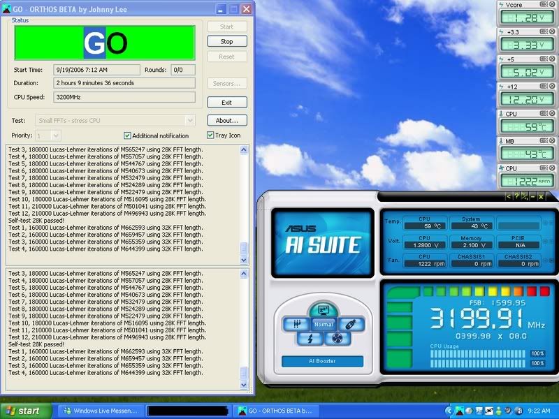

sorry, miscommunication there, what I meant was:
which utility is that that is showing a bar of Vcore and Temps on the screenshot you posted? Is that PC PRobe II?

Yep. that's PC Probe II from Asus :)

Dexion, I've tried to run two instances of Prime95, but when I edit the target line, it always says "Invalid" something or other. Is there any way you could help me with that?
Thank you for your time :)

Make sure there is no space between the dash(-) and the A0 or A1.
EX:C:\Prime95\PRIME95.EXE -A0

Well I tried that. Here's my example:
"C:\Program Files\Prime95\Prime95.exe -A1"
and...
"C:\Program Files\Prime95\Prime95.exe-A1"
Neither of which work. :(
Either there is something wrong with it or I'm too noobish!
