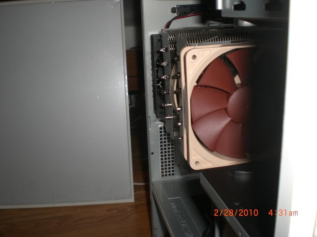

I'm buying a new i5 3570k which I'd like to have stable at 4.5. The Noctua NH-D14 would be my default choice, but I've heard it won't fit in the 900. I really don't have the money to get a new processor, aftermarket cooler and case.

How big is the 900, mine fits fine in a Fractal case about the size of the Antec 300. There isn't a ton of clearance but who cares. I thought the 900 is even bigger than the 300.
