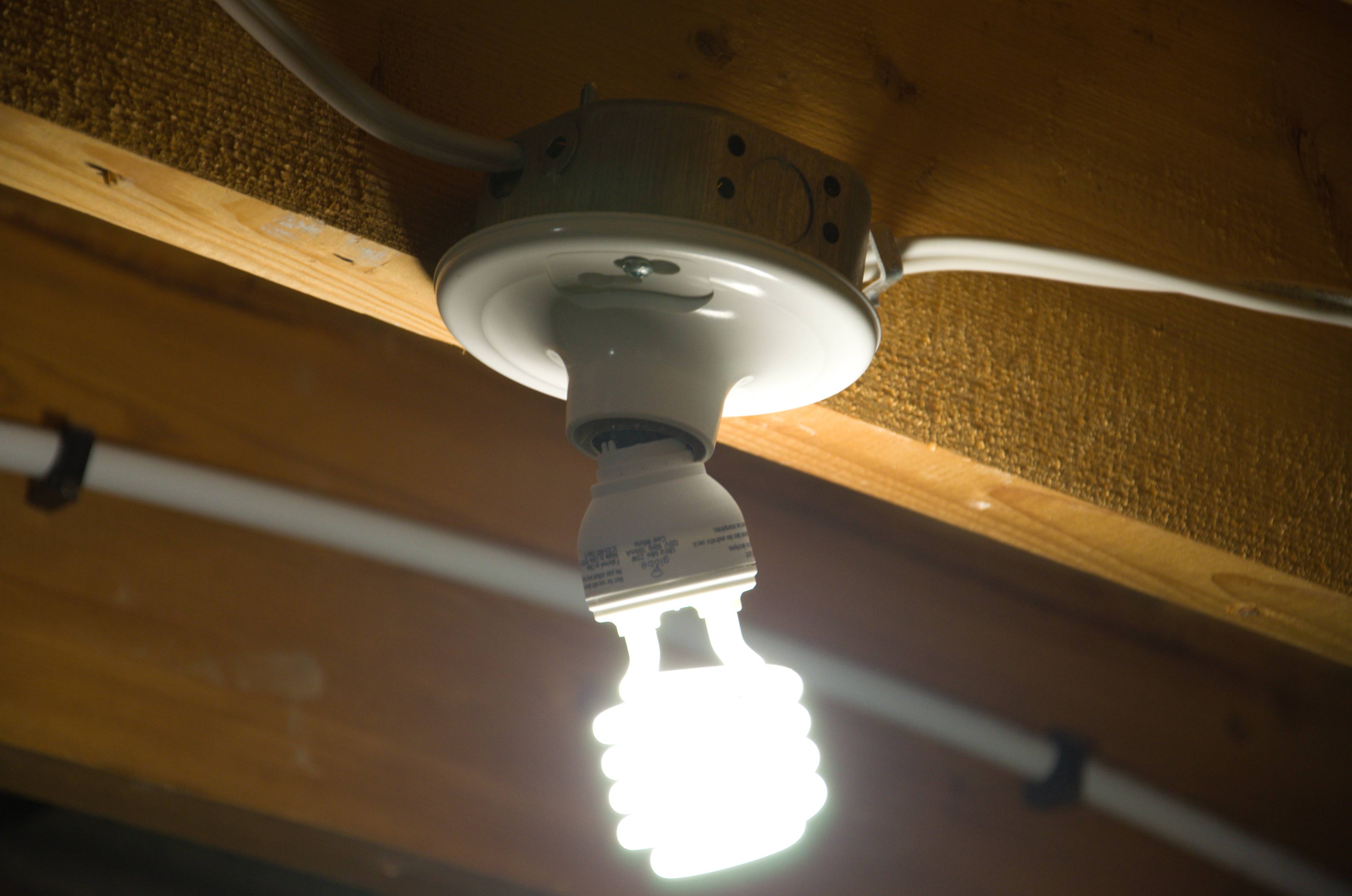

I had a CFL make a funny venting sound and burn out once when turned on, but I'm pretty sure it had to do with the fact that I had previously accidentally hit it with something and half the spiral was missing. :biggrin:
Though the best was this:
It stayed like that for a month and worked fine then I decided I should probably try to fix it, but I ended up breaking the thread of the bulb and having to throw it out. That one got hit with a 2x4...
I'd say half the CFLs that died on me were due to my own clumsiness. :awe:
