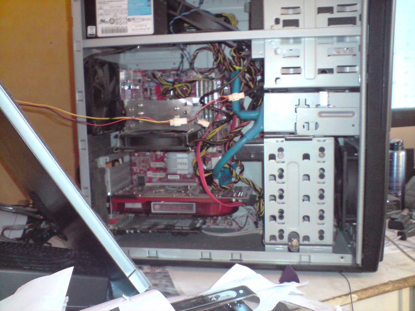

EDIT: Here is a rather rusty looking picture of my setup. As explained, I am useless at "tidy" and its currently not looking the best as I am awaiting some more advice before delving in again.
Those temps sound fine, when are you getting those higher temps from your first post?
Ultima 90 comes with 92mm mounts. Check your swag drawer.
I'd ditch the top "crossflow" fan. Unless you have serious ram overheating issues all it's doing is disrupting airflow, and probably pushing hot air back down toward your video card.

Just installed my Thermalright HR-03 GT (Tuniq TX-2 TIM) with the heatsink facing up, just below my CPU. I have also attached an Arctic Cooling Turbo Module to it to blow down onto the GPU.
Ambient temp: 23C
Idle: 51C
Load (30 mins Hellgate:London): 57C
This is at 790/1000 via CCC.
Furmark is crashing my PC out for no good reason today so I cannot use that to test.
The problem I have now is that my GPU and CPU are both wanting the same air and as a result, my CPU temps are going through the roof when applying load, rapidly dropping to normal quickly after load stops.
I may have to re-fit the heatsink below my card to resolve that issue but overall, things feel cooler inside.
